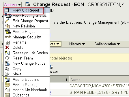

You have to install the Business Reporting Module...it will give you the ECN Summary Report that opens in Cognos.
[cid:image001.gif@01CB9C5E.DAAF1FC0]
