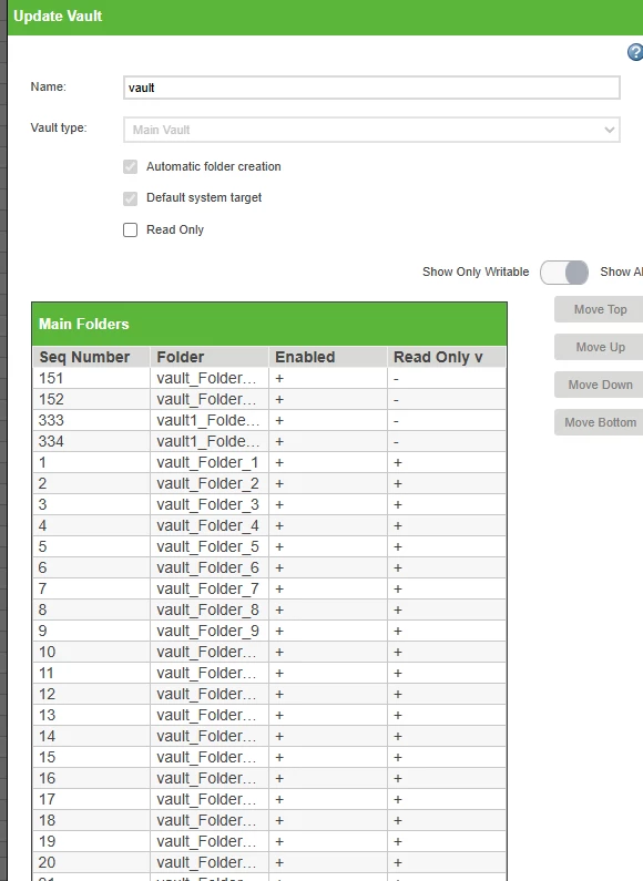

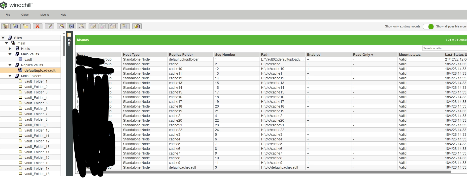

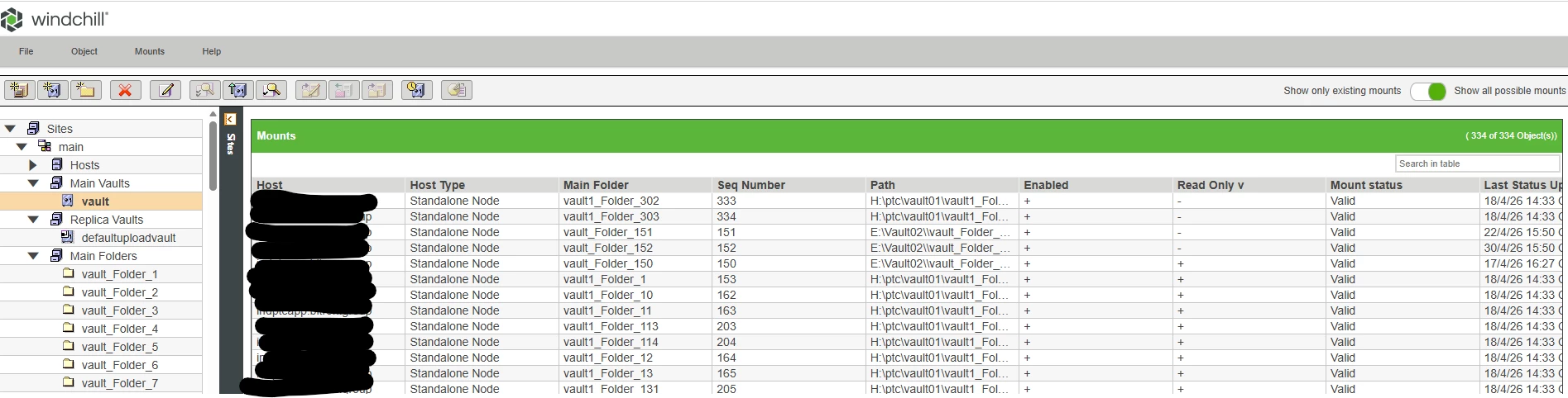

I see that on my fileserver Administration, most of the folder seems in ReadOnly:
on the main site, the replica vaults it seems are not in read only:
on the all other sites, it’s seems the same .
if i click on the update Vault button, i see the “read only” option, but is unchecked:
i have no experience with this application, so i don’t know how to move inside.

i have solved the problem. from Main Vault→ main of the Main site, there was the “read only” flag. once i remove it, it start work correctly.
