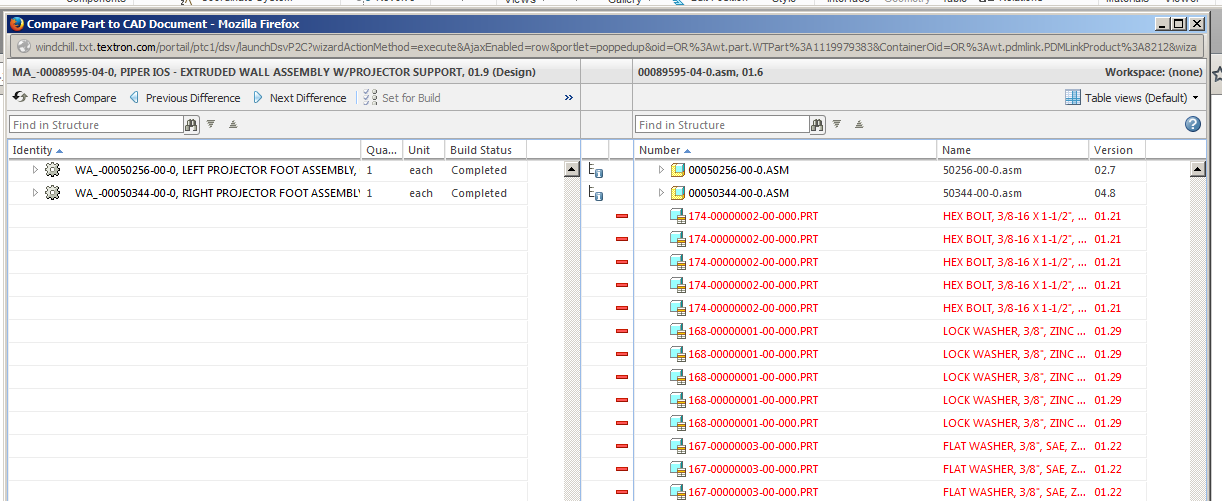

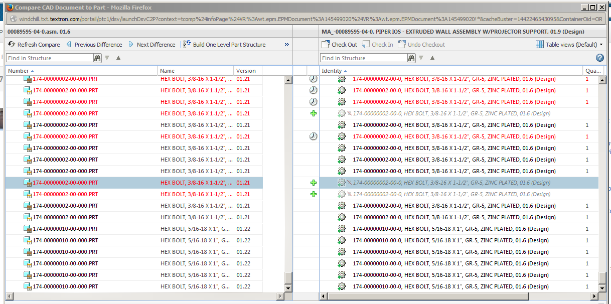

Normally, when we are creating a Windchill WT part structure from a CAD document structure, everything is working fine and the building process goes flawlessly. Now, for some reason, we have some assemblies were some of the parts don't build, which result in parts quantity different in WT structure.
As in the example below, in this CAD model, I have a 24 instances of the part 174-00000002-00-000 in the top assembly. When I try to build it (from the CAD structure), the WT structure shows that there is only 19 instances, and I can't get it to synchronize properly. (In this case, more parts have the same problem). Every CAD parts has an Owner relation with its WT part.

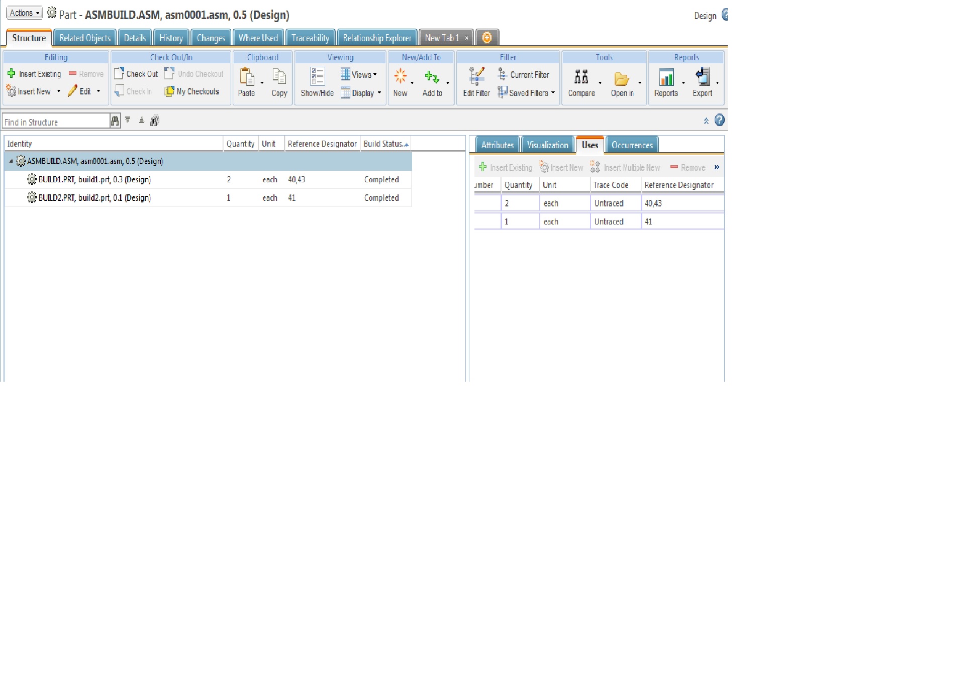

hi
the reason is that you add the part using "add existing part",but this part is already in the assembly,so the part has two build status, exclude and complete. windchill can not build a cad part for the wt part with exclude status.
to add the part already in the assembly, modify the quantity of that part in the assemly via "uses" , and give an another reference designator number for this new occurrent, , compare the wt assembly with cad assembly, change the status from exclude to to build, and rebuild, the cad part is added to cad assembly.

Hi
I'm not sure I completly understand how the Reference Designator works. Do I have to add a random number for each missing component?

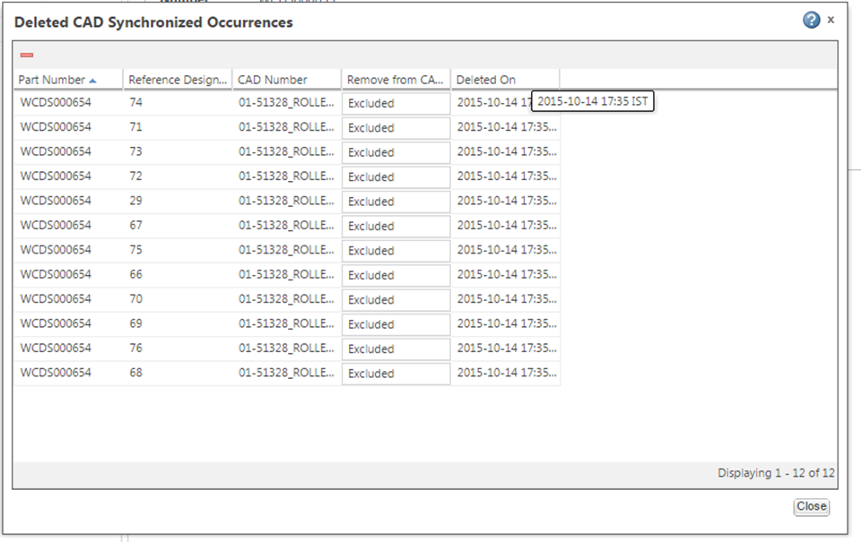

Oct 14, 2015 12:10 PM UTC
Hello.
Did you see if the Part occurrences built by CAD were deleted by someone?
You can verify this by:
- Go to the info page of ASMBUILD.ASM, Structure Tab
- In the tree, right mouse button click on the assembly and from the contextual menu choose CAD > Manage deleted occurrences
If you have any (like in my image above), then delete them and then:
- Go to the info page of the CAD Document related to ASMBUILD.ASM
- From the actions menu at the top of the info page, choose "Build Associated Part"
