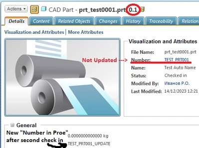

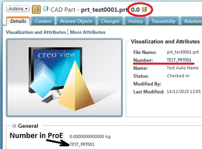

So, I create a new object in CREO. I give it a name and number. After check in, I see these parameters on the Windchill server:
In Windchill I see this attributes:
Version 0.0, Number in Proe: TEST_PRT001, Number: TEST_PRT001
After that, I open this model in Creo and change the "NUMBER" in the model parameters. I enter a new value, for example TEST_PRT001_UPDATE
After that I make "check in". And I see this on the server:
The "Number" in the attributes was not updated. Is it possible to make it automatically updated after "check in" ?
For now, in such situations, I have to change the number manually in Windchill.

What attribute do you change in the ProE exactly?
It seams that it is just model parameter and it is not system parameter number, file name, or common name.
