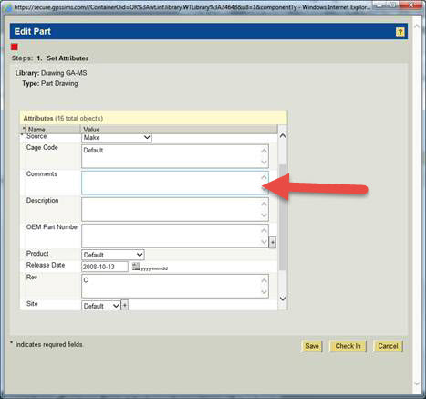

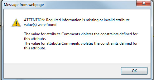

I have one record, that was migrated to Windchill 9.1 years ago.  It is just now being modified, but it gives me an error when I do check out and edit, then check in.  "The Value for attribute Comments violates constraints defined for this attribute."

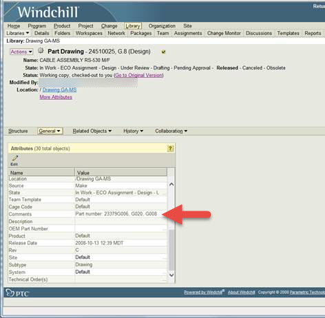

So there is a value entered in the Comments field it is "Part number: 23379G006, G008, G020", but when I do check out and edit, the Comment field appears blank.   How can fix this?

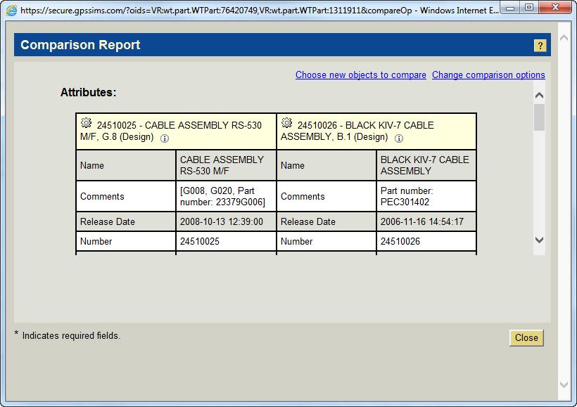

I did a compare on another similar record that I have no problems checking in.  I notice on the problem record that there are parenthesis brackets in the Comments field.  I wonder if it's the brackets that is causing the issue?

The "single value" constraint is applied to the type, which then propagates to objects as they are created.  While it is possible, it certainly isn't feasible to single out objects of a specific type to remove this constraint while others have it, without some serious DB modification.
What I would suggest is to use the steps I supplied above, and see if you an isolate the three records in the stringvalue table that construct this "entire" value.  Modify one to be the "complete value", and then delete the other two.  Thus, instead of removing the single value constraint, you actually consolidate the three values to one.
