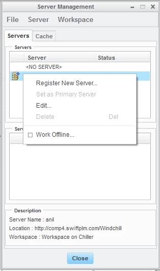

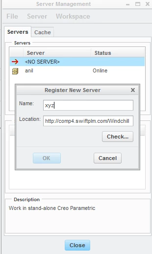

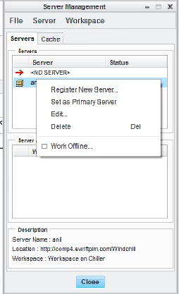

January 30, 2019
 Today i got a same issue, what i found it . . Previously i had a access to product after that Admin denied the access to it . . . while at the time i was integrating creo to windchill, i got the error.
Solution: if you try to delete or edit the server it won't. . so while at the time we can't register new server also .. . Only one thing to do rid of this. .. .  set primary server as <no server> and then it enable the delete option, then you can delete the  user or server, which you created before.
now you can register  new server as a primary server.
Please find the screen shots  for better understanding.
I hope it helpful to all.
