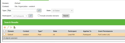

In any given Product / Library, one can change the Manager Role's permission from "All" to selected permissions.
Alternative: Can create an additional context Team Role and assign user(s) to that Role. Assign to the Role.
For either the Manager or new Role, specifically assign Set State, etc.  Have to either choose WTObject or specific object types to set state on.  There are multiple "Team" objects - have to ensure that you have an ACL against the correct one.

I tried adding an ACL for the participant that matches the role that I wanted to assign
but when testing it doesn't allow the user to Add or remove tasks

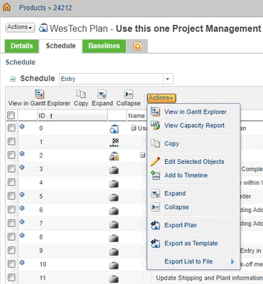

Is there another ACL that needs to be added for Task management? I don't see a type that would match that from my understanding.

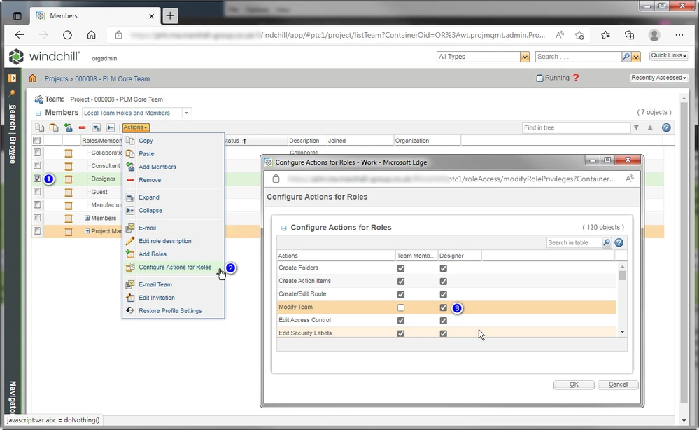

You can allow a Project role to edit the team (add/remove project team members)
We created a 'PLM Team Manager' role who has 'Modify Team' permission and added that role to the Project/Product/Library templates

Yes Modify team is an option. My issue is that I can't see an Access Control or Configure Roles for adding, or continuing tasks in the Product Plan that uses the same set of roles. So for now we are using Product Manager to be able to but that allows a user set state among other options that I don't want to allow.
