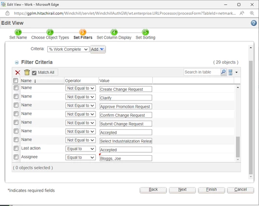

Wondering if anyone knows if it's possible via a wildcard or otherwise to filter 'product tasks' for specific 'and' conditions on tasks.
Currently using the product tasks section to get a live overview of change tasks that are open and who they are sat with.  Currently this gives an overview of the whole project but I was hoping I could filter this down to be able to have specific views for certain teams within a department.
So like the below, this would show me the required output for Joe Bloggs, but how could I add John Smith and others to this report to be able to filter on a smaller group of individuals?
Any help much appreciated.

Jan 9, 2023 9:06 AM UTC
Thank you all.
In the end my colleague identified continuing the use of 'Not equal to' for the assignee group also.
Unfortunately we have quite a large engineering community so quite a few names to populate but the outcome gives me the change related items I'm looking for as a live view.

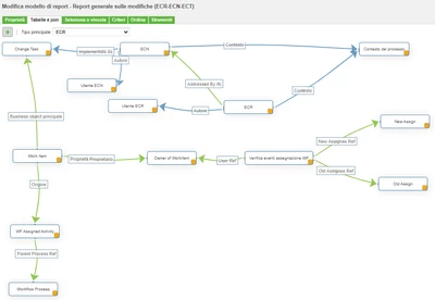

You can use a report query builder.
I have a complete one for all the objects related to the changes.
It is quite complex and also has several attributes with text in Italian (but they should be easily translatable to find the names used in Windchill)
Below you can see the diagram of the used tables, joins and outer joins (to extract data even if one of the tables does not return any data with the imposed conditions).
Some tables are used multiple times to extract user names.
I may share it but you can hardly import it into your system without errors.
These are the used criteria

DH_91668617-BedrockAuthorAnswer
7-Bedrock
Thank you all.
