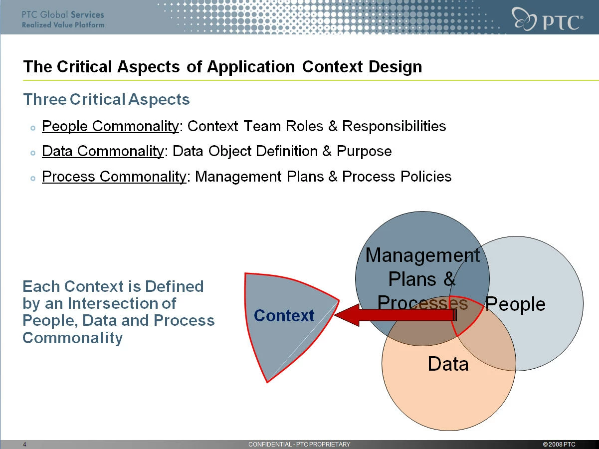

There is no one answer to this question. The "scope" of any given Product or Library may vary considerably based upon the business needs of an organization. The critical key is to design a solution that creates a Products and Libraries with a balance of the three primary aspects of context design: People, Data, and Processes. The intersection of these three "sets" is where you will find logical Product &Library definition. See the attached image.
One thing to remember is that you should never attempt to use Folders to try and define "Sub-Prod/Lib", This will only lead to problems, as folders only address the "data" aspect of design.

Thank you @RussPratt. I found many comments about Product definition but yours is probably the most interesting one, even after 13 years !
I like the powerpoint slide you attached, do you have another one more up to date ?

The most recent version is in a recently retired Portfolio offering.

This is very helpful to keep in mind. Reading the other updates there
are lots of good solutions for the specific company and need.
For example, Kenworth and Peterbilt have one "product": a truck (with
thousands upon thousands of options). It certainly doesn't make sense
for us to use just one Product container though. Good timing too as
we're revisiting a layout that was dominantly defined by Data.
