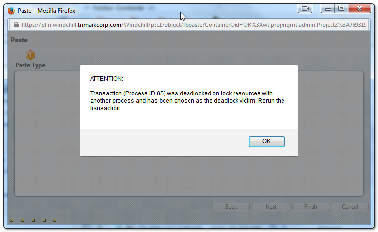

We are currently on Windchill 10.1 m040 and are using ProjectLink, and in one Project no team member can cut from the main folder and paste into a sub-folder. This is all within the same project. No error message is given, but the paste window just says "Loading...." until canceled. It is the same with a single object or multiple objects. Objects being cut and pasted are CAD / EPM documents.
I have tested other projects with the same conditions and it works in those projects, so it seems like just this single project.
Anyone run into this before?

Additional information:
I let the cut and paste run for ~10 minutes and it finally came back with this error:
(Transaction was deadlocked on lock resources with another process and has been chosen as the deadlock victim. Rerun the transaction.

Additional Information:
Tech support call logged.
I have done some more testing and this does affect other projects. Every project that I tested it on in fact...
The behavior is this:
  • cut and paste shared CAD objects and paste into a directory, works as expected. 100 objects in ~6 seconds. Directory has over 2000 CAD objects in it.
  • cut and paste native CAD objects and paste into same directory, takes an hour to complete. 18 objects in ~1 hour...
  • cut and paste native CAD objects into an empty directory, works as expected. 12 objects in 5-6 seconds.
I am guessing something strange going on with the database?
May 12, 2015 10:31 PM UTC
It could definitely be a DB issue. Taking thread dumps periodically during that hour would give you a better idea of what Windchill is doing during that time and where the problem is.
