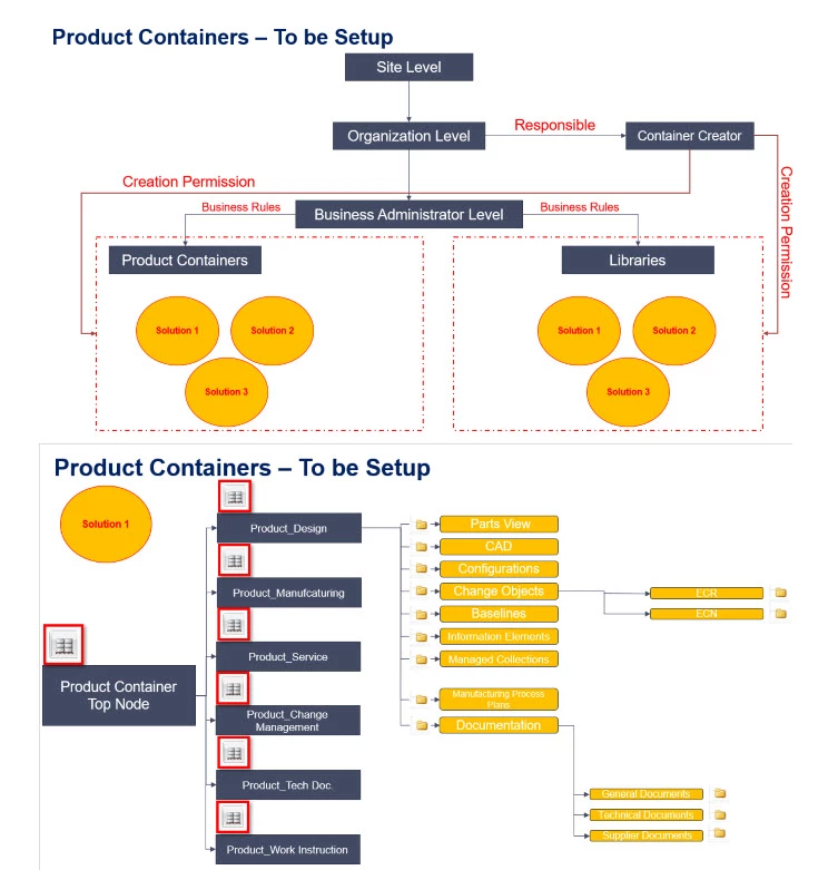

PRKAC1-VisitorAuthor
Aug 20, 2020 7:58 AM UTC
Hi All,
At this point, we would like to analyze the solution & hear back from the community members if anyone has implemented the same across there organization & have encountered any challenges while doing so.
Planned Proposal:
Refer to the below attachment.
PRKAC
Aug 20, 2020 8:37 AM UTC
Adding to the previous thread...!!!
Also, if the solution presented in pervious is implemented, what are the pros & cons of the solution implementation:)
Looking forward to hearing back from the champs in the community.
