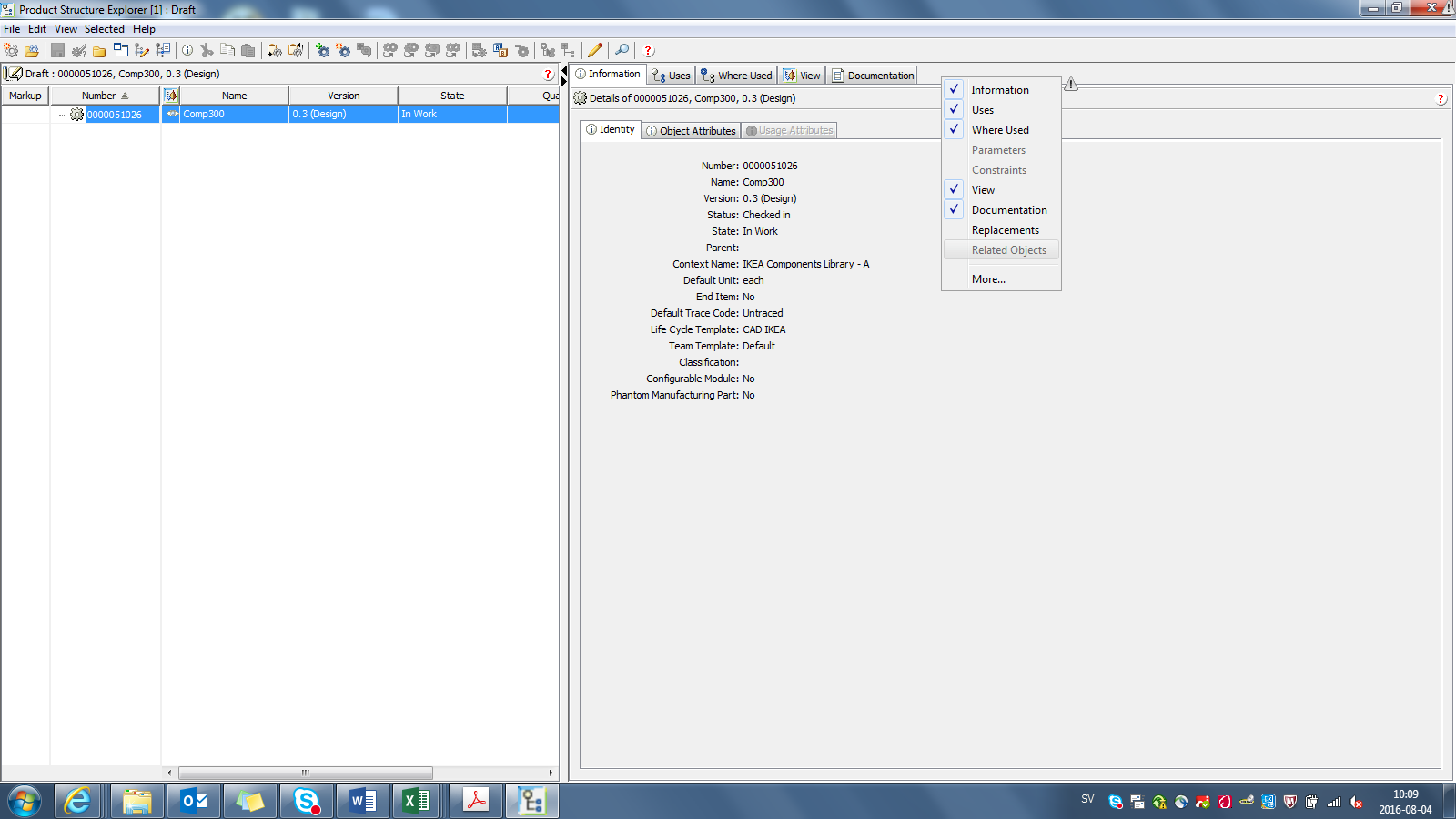

1. In windchill 11, why iam not able to see the action "Open  in Product Structure Explorer"?
2. in Windchill 10.2, Why iam not able to add the tab " Related Objects" in the PSE ?  See Below.,

Hari,
As we continue to drive functionality to PSB and remove Java applets we have PSE turned off by default in Windchill 11.0 F000.  There is a preference to show the action.  However I would strongly consider only using PSB for specific functionality such as Parameters & Values optionality.
(Utilities Tab) Under the Preferences -> PSE -> Enable Product Structure Explorer (PSE)
For the 10.2 Related objects - I am not sure off hand - that might be a TS call.
