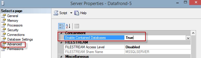

Apr 17, 2018 2:10 PM UTC
Hi Dan,
Before running PSI, can you please check for the 'Enable Contained Database' value to be True on your SQL properties.
And please do check if you have admin access on your DB machine.
Check if the DB port is free or occupied with any other instance on the SQL machine.
If you are ruinning the PSI from a different machine (not from SQL machine), then check if you are able to access the SQl machine and Port by running telnet command.
Irfan
