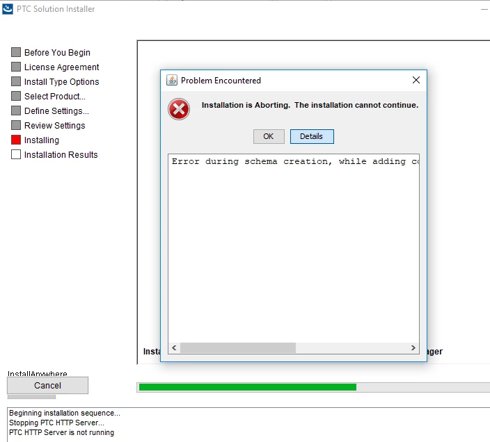

AddingColumns.PNGHi All,
I am trying to install Windchill 11.0 M030-CPS11 on Windows 10 machine. I am getting the attached error and the installation is then getting aborted.

But even after the property value got changed the installation is getting aborted. The PSI Installer error is as below
Updating database schema... be patient.
Java HotSpot(TM) 64-Bit Server VM warning: ignoring option MaxPermSize=128m; support was removed in 8.0
joining with std out thread
std out join complete.
joining with std error thread
std err join complete.
AddColumns -u -s process returned non-zero: 1
Installation is Aborting. The installation cannot continue.
Aborting installation.
Error during schema creation, while adding columns. See the logs for more information.
aborting: original exit_code = 2

Jul 31, 2019 2:32 PM UTC
You can try by unselecting shortcut creation option. I had got same error multiple times and after removing shortcut creation it worked.
Aug 21, 2019 9:09 AM UTC
Did you create the db user via PSI or used existing db schema ?
i'm using existing db schema and its failing with error " Error during Schema Creation".
Aug 21, 2019 9:49 AM UTC
If its a cluster setup and this is your second installation you have to select existing user and also you have to uncheck "create database schema" and "import data" options.
