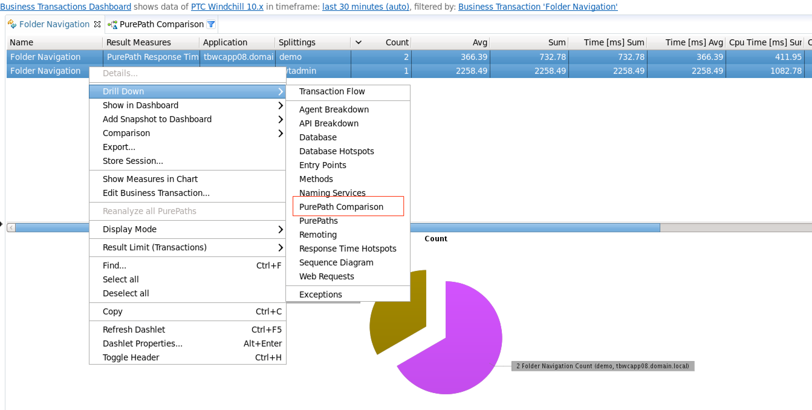

I am new to PTC System monitor. I installed PTC System monitor and able to configure it successfully and getting all dashboard. I have a query, can I get report/dashboard that shows comparison. let say I want to compare Av. response time of "Windchill Folder browsing" before and after some customization deployed.
My problem is, if I am adding same dashlet 2 times with different time frame as filter in a dashboard, it is very hard to compare on graph due to different time frame and graph showing older time frame, starts capturing current data also.
My objective is that I should able to store a data as baseline and later i can compare it with current data. if it is in single graph it will be great.
is it possible with PSM?
Can any one guide me?

You can start with Business Transactions > Folder Navigations.
In there, identify the transactions which you would like to compare. RMB >  Drill Down > PurePath Comparison
In this screen, you can do Purepath Comparison - Including the methods,Structure. In your case, I would compare the method hotspots as well. If you drill down there, you should be able to find the methods called - under caller break down which shows individual contribution.s
http://support.ptc.com/WCMS/files/142899/en/WNC_Analyzing_Slow_Transactions.mp4
http://support.ptc.com/go/psm
