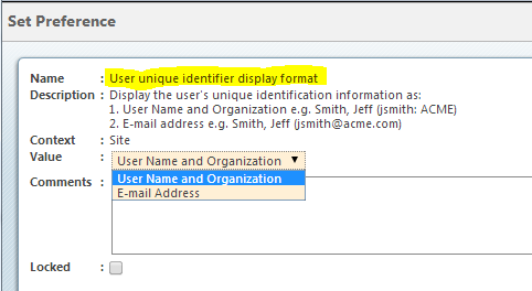

  • Since Windchill 10.2 the value of PTC_WM_CREATED_BY and PTC_WM_MODIFIED_BY contains a bracket with the information “(<username>:<organization name>)"
  • The preference User unique identifier display format controls the format string with the following options:
    1. User name and organisation
    2. Email
This means that starting in 10.2, if you use these system parameters on your drawings, the drawing will now display either just the email address of the user or the organization appended to the username. Nice. I wonder how many title blocks will have to be redesigned... Too bad they can't just add an option for "User Name" to at least maintain previous functionality.

You wrote that the display format could be configured:
    2. Email
Where? How? Hidden config.pro option?

I have no idea if this applies to PDM Essentials. In PDM Link it's "Browse", "Site", "Utilities", "Preference Management", "Display", "User unique identifier display format".

It seems, that setting this option on Organisation level ("Organisation", "Utilities", "Preference Management", "Display", "User unique identifier display format") has no effect.

Here is a short summary as to how this issue arose and why it has taken so long to address:
There was a requirement to have unique identifiers for users implemented through the preference User unique identifier display format. During 10.0, an inconsistency was identified in user names where in some cases it showed the unique identifier, and in some cases it showed the display name. An spr was filed and fixed to use the unique identifier. This changed the format of PTC_WGM_CREATED_BY and PTC_WGM_MODIFIED_BY which resulted in more sprs from customers that did not want these values changing on drawings, etc.
There were several discussions about how to address the issues. The end result is that we need to introduce another option that allows users to decide if the unique identifier should be used for these attributes. If they are not to be used, the old format is retained.
That preference is going into 10.1 M050 and 10.2 M030.

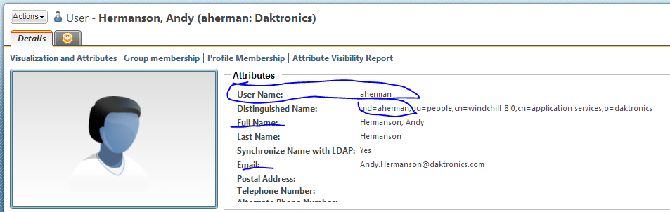

Will we also be able to choose username like we used to? Would be nice to have options that we can call into
