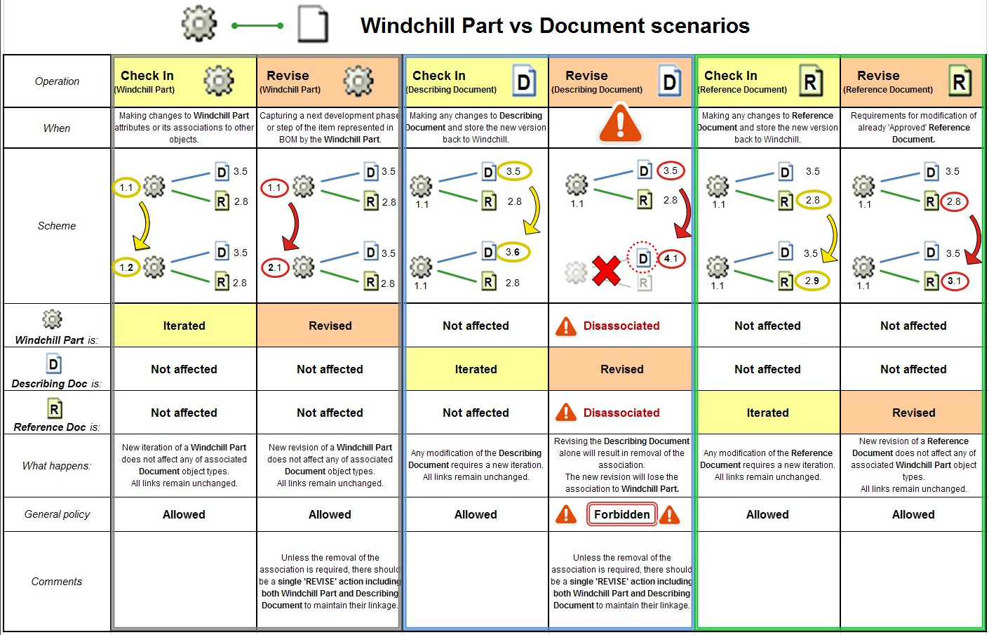

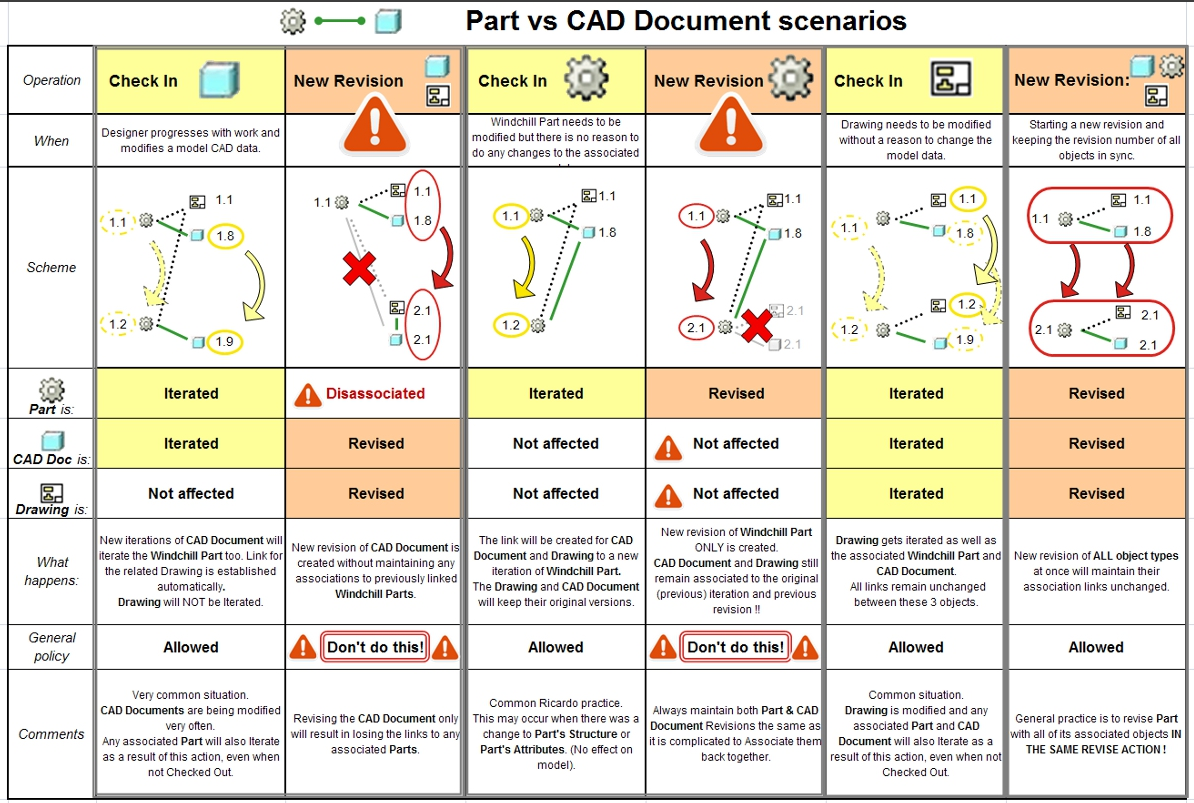

The characteristics of the link you use between document and part is important. EPM Build links (owner, contributing content, contributing image, image), Content, Describing Doc are all WTPart version to EPM/Document version. Any changes to link are captured by a new version of WTPart.
  • Iterating or revising a WTPart in isolation will copy the links forward onto the new WTPart version. Resulting in multiple versions of WTPart linking to one version of document.
  • Iterating an EPM/Describing Doc will create a new version of WTPart automatically. The new document version is linked to the new WTPart version (with same link type).
  • If you revise an EPM/Describing Doc in isolation the new Doc revision will NOT be linked to any WTPart.
  • If you revise the EPM/Describing at the same time as "EVERY" linked WTPart, the links are carried forward onto the new revisions of WTPart and EPM/Doc.
Reference Links (used by Reference Document) are WTPart version to Document Master. Every "linked" version of WTPart points to latest version of document (with optional state filtering)
If neither of these characteristics suits your needs it is possible to create your own links, but this is customization.
When engaging in the practice of revision syncing documents with WTPart, the moment you have multiple associated documents this can cause problems.
