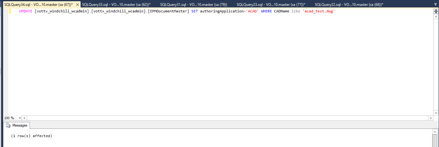

Publish AutoCAD file stored in Windchill as CAD Part
As most of our Organizations in 10.2 are using Creo 2.0 (some upgraded to Creo 3.0), we still have many 2D AutoCAD checked in as CAD Part or WTDocument data types.  There is a PTC document CS32402 that covers how to publish AutoCAD stored as WTDocument in Windchill, but I cannot find any document providing any solution to publish the AutoCAD file stored as CAD Part in WIndchill 10.x.
Has anyone have this similar need to publish the AutoCAD file that is stored as CAD part?  Are there any third party tool that can do this job?

Oct 30, 2015 2:46 PM UTC
I have hack for import CAD documents,
We use WGM in Creo for import Autocad files, and after that change field in database Windchill (authoring Application) to ACAD - profit !
If you want I describe this process.
Dec 2, 2015 2:35 PM UTC
Please do, Renat
Dec 14, 2015 3:58 PM UTC
Sorry for waiting,
Steps for importing DWG as EPMDocument:

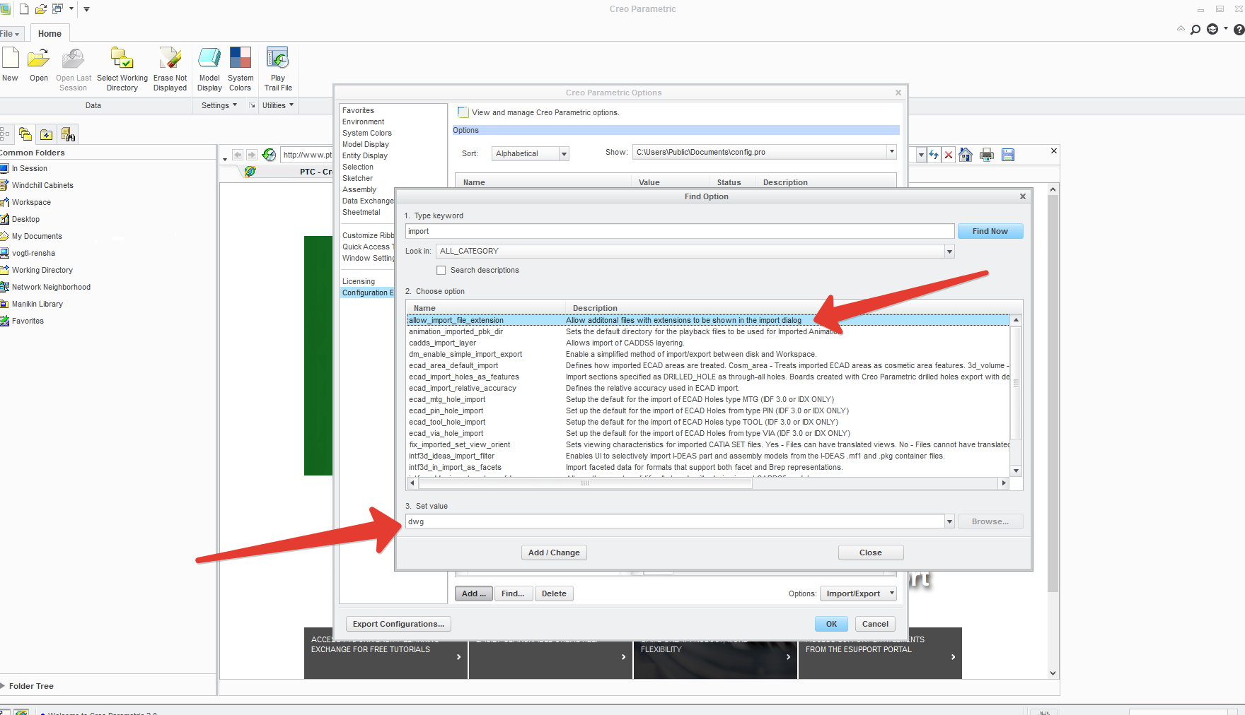

0. Set property in Creo for import dwg in Creo:

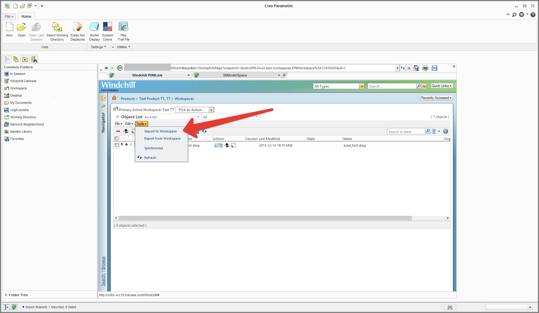

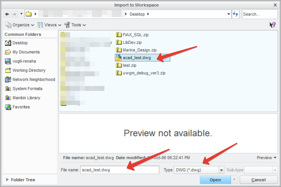

1. Import dwg file in Creo Workspace

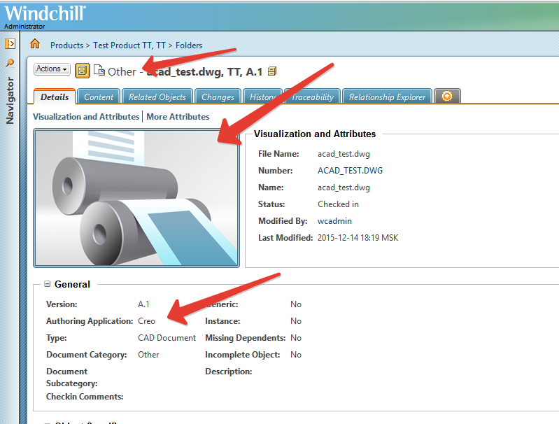

2. CheckIn to Windchill, and look:

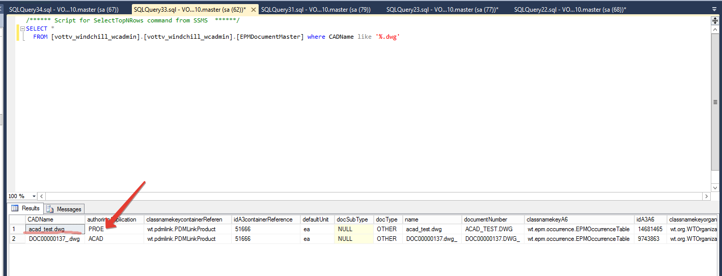

3. Open SQL studio and find file - SELECT * FROM EPMDocumentMaster WHERE CADName like ‘%.dwg’
4. Update fields in table
UPDATE EPMDocumentMaster SET authoringApplication='ACAD' WHERE CADName like 'acad_test.dwg'

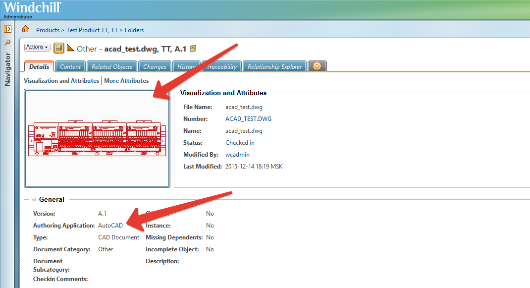

5. Profit! After change authoringApplication you can recieve good preview.
