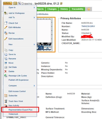

We did add watermark to Creo view too. When we open a data on Creo view, we can see it. Actually, we want to publish datas with watermarks.
How we can set this?

6-Contributor
Mar 5, 2023 1:33 PM UTC
For example; When we use this option (you can see on the image), it'll create a pdf. I want to see the watermark.
When we click on watermark option, we can see that. If I can achieve this, I'll be really happy.

TomU
Mar 5, 2023 6:21 PM UTC
We use Fishbowl's 'linkAccess Trigger' product to watermark and stamp all of our PDFs during publishing.  It's highly configurable and works very well.  There is also a free (and paid) version of the Watermark Starter in the Windchill Extension Center.
