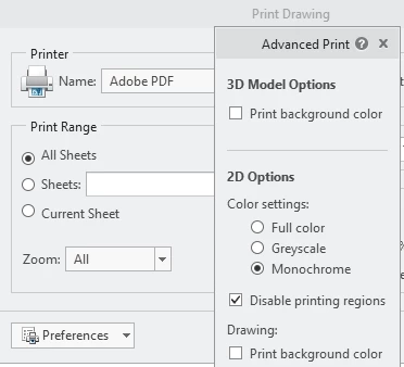

Jun 28, 2023 7:57 PM UTC
Are you printing through Creo View? If so, you should have options like above where you can control printing in monochrome or color. The creo worker should be where you control how PDFs are generated and if they are color or not. I publish both HPGL/2 default and additional PDF via publishing rules. As far as defaulting based on printer how it prints, I do not think that is a setup you can make in Creo View but you have options on changing printer and color vs monochrome. I would think that the Windows Print Settings setup. IT here would default all our printers to B&W to save money.
