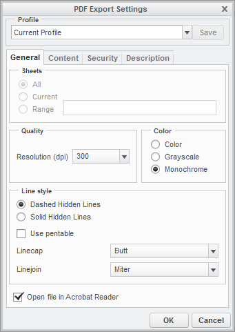

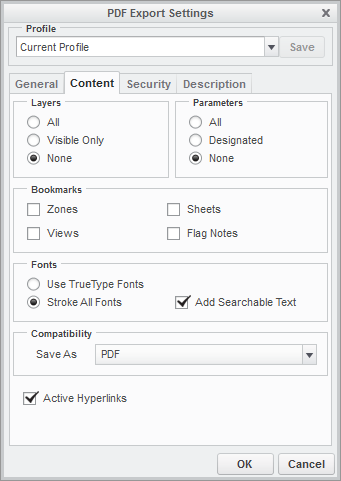

Sep 13, 2016 6:45 AM UTC
Try with below configuration in PDF export settings. Do exactly per below two images and I think you are done. You can set higher resolution for bigger drawing but it will increase file size.
Jitu Thakor
