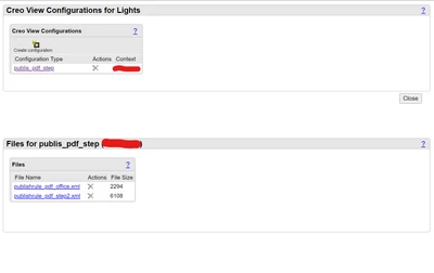

 I have a strange issue that suddenly popped up without warning. I cannot anymore publish Creo drawings to PDF. I cannot even choose to publish them manually in Windchill even, the choice when creating a representation is not there anymore. This has been working beautifully before and just gave up with nothing being changed in the publisher config recently ( in the last 5 months). There is an error in the logs:
2021-05-04 15:41:37,959 ERROR [ajp-nio-127.0.0.1-8010-exec-221] wt.wvs.publish.PublishRulesHelper User name - No <authoring-application> with name=PROE
Has anybody encountered a problem like this before?

sconroyAnswer
May 17, 2021 9:08 AM UTC
If a CPS has been applied it might be worth looking to that in your wvs.properties it has publish.usesPublishRules="ARBORTEXT PROE" and if possible merge both publish rules to 1 file as can cause problems with 2 in some versions of Windchill
Regards
Shaun

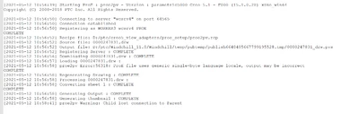

May 11, 2021 7:58 PM UTC
Hi Henrik,
Looks like you need to debug the issue. Please check your agent.ini file. If the CADWorker it self might be down.
Creo publishing is normally very smooth.
Thanks and Regards
Ajit
Henrik_F10-MarbleAuthor
May 12, 2021 8:07 AM UTC
Hello and thanks for the suggestion. The cad worker is up and running and finishes successfully. It creates the creo view representation without issues.

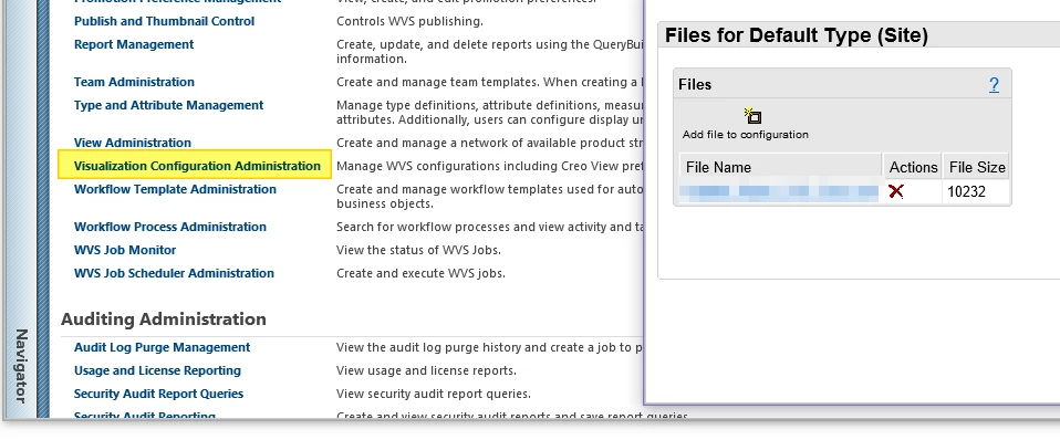

May 12, 2021 4:53 AM UTC
Hi
Check "Visualization Configuration Administration" and verify the xml file.Image 069.png
May 12, 2021 6:29 AM UTC
Hello and thanks for the suggestion. I tried to re-upload the xml, which hasn't been changed in quite a while, and it accepted it with no errors. Is there any other way to verify the validity of the file?
sconroy1-VisitorAnswer
Regards
Shaun
