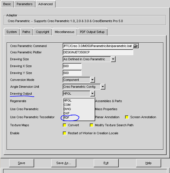

Recently our users began inserting jpg images into their CAD drawings to provide reference information. The images display properly when plotted/printed, however when the drawings are checked-in to PDMlink, our cadworker fails to publish the embedded jpg images.
I'm certain this error is 'Admin Inflicted', and that I am probably just missing a step in creating the recipe file, but for the life of me I can't seem to figure out what I'm missing.
I would appreciate a little nudge in the right direction.
We are using:  Creo Elements / Pro 5.0  and CreoView3 Adapters.

Ah, I should have read your original post more closely.  No, EPMDocuments (CAD Documents) are still going to be handled by the normal publisher (CAD Worker).
What format are you publishing your drawings to?  You may need to switch to PDF.  I'm not sure if any of the other types will properly embed a JPG file.
