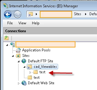

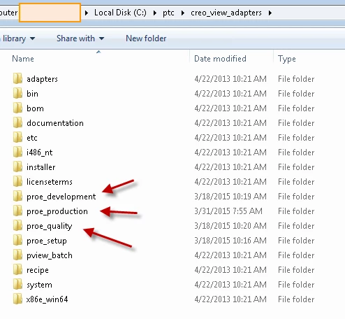

We just have the Creo adapter, but I have it setup for production, dev, and QA servers. One worker defined on each.
This worked fine in 9.1. The worker on each server pointed to its own folder.
I suppose I could set up unique virtual folders in the FTP site for each server also. Right now I have it set so all use the same folder.
Right now I'm just trying to get one server going.

We are using FTP because, with all the security restrictions we live under, an open share becomes a problem.
Besides, ftp just seemed a more robust method. I was always having issues with the shared folder method.
