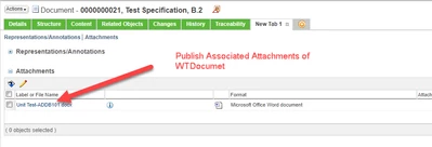

The requirement is very straight forward. I want to Publish secondary content(Attachments) of WTDocument.
