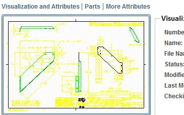

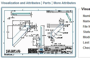

We recently had a consultant update our two worker machines to Creo 4.0 and CV Adapters (latest).  They decided to delete everything and start fresh.  Great except we are having issues with colors on drawings.  The thumbnail used to show up with white background and black text/model (top)....now looks like this (bottom).  How do I restore monochrome publishing?  Note when you open the drawings in Creo View they are correct - both are monochrome.

Do you see the yellow text in Creo on the cad worker?  If so, then change the system colors.
If it looks fine on the cad worker, then take a look at your plotter config files, pen tables, and related config options.

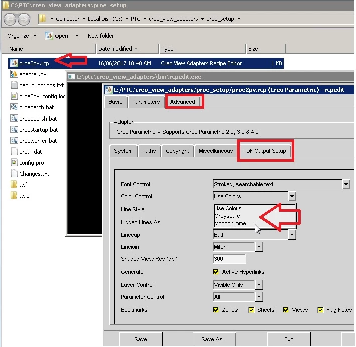

Best option is to just update the recipe.
  • Backup your old recipe (its a very small 1kb file)
  • Open up your CREO Publishing recipe. Most like this is the location on your worker machine (C:\PTC\creo_view_adapters\proe_setup\proe2pv.rcp)
  • Advanced ---Color Control -- change to monochrome or greyscale
  • See attached image (the whole process should take 30 seconds)
