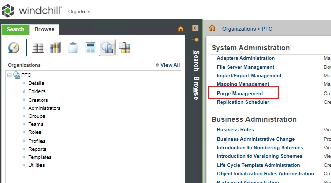

I am using Windchill PDMLink Release 11.0 and Datecode with CPS M010-CPS03
Keep the latest version of the file, purge versions and version sequences other than the latest version
Translated the text from Simplified Chinese to English using Google Translate.
Subject: purge文件版本版序
Body: 保留文件最新版本,purge除最新版以外的版本及版序
- By community moderation team
Rocket_Max
October 31, 2023
Hi @HH_10580701
Please use Purge Manager
  • Purge Management is used for deleting earlier (non-latest) iterations of objects i.e. Documents, Parts or EPM/CAD documents
  • All or All But latest versions can be purged. All versions are included by default
  • Purge Management can be accessed by navigating to Site or Organization > Utilities > Purge Management
  • Only the Org admin and the Site admin can access Purge Management
https://www.ptc.com/en/support/article/CS20325
