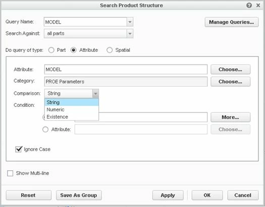

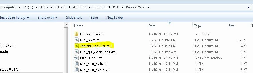

Attached are two images...one shows the search UI in Creo View 3 M030 MCAD (not lite) and the other shows where the search query is savedfrom the client session. I too am very interested in knowing if this search can be pushed up to the server as an available search to all users. PTCdocumenation notes how to get the user_prefs.xml to be a server file...but not the searchquerydict.xml file. I'm pretty sure other customers will want this functionality.
My pictureshows a backup folder for preferences...I highly recommend that as a good practice!
