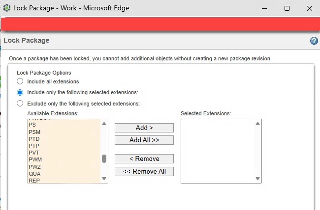

I am using Windchill PDMLink Release 12.0 and Datecode with CPS 12.0.2.25 PVZ is missing as option when creating Technical Data Package Here are the errors that I faced When configure Technical Data package to include PVZ, PVZ is not an option to select and so PVZ is missing in output Technical Data Package Steps to reproduce: -Create new package in Product context -Select Technical Data package -Configure Technical Data Package to include all publish content -Select Lock in package -Add PVZ content (missing as option in the list)

Yes indeed we have no PVZ as option and yes we have setup to create viewables. There are viewables (PVZ) in the system. When locking the package the PVZ extention is missing and this is the reason I miss PVZ's in the Technical Data Package. We found already an article to expand extentions but this was not helping -Article - CS216155 - How to exclude a certain file type from package zip if the extension is not available in the list in Windchill PDMLink

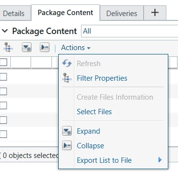

Sep 22, 2026 10:27 PM UTC
if you go to package content > actions> select files
then don't you see this?

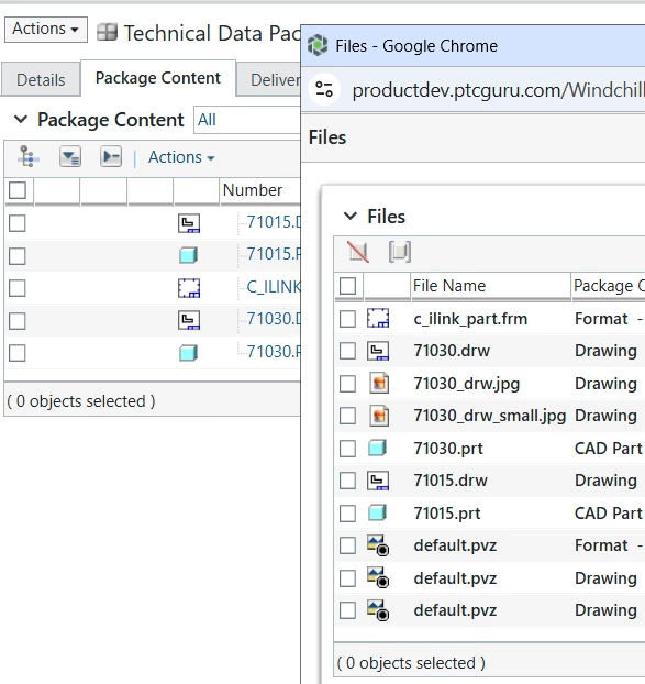

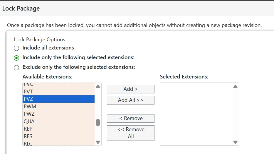

Sep 22, 2026 10:56 PM UTC
In my case I don’t have the “Select files” option but the PVZ files come in just fine.
