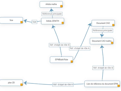

Use Case: I want to create the following report : Extract the list of wtparts having an EPMdocument linked as owner and which has a drawing in calculated link
Description:
I don't know how to get the calculated link information between the EPMdocument and the WTpart.
Does anyone have an idea to get closer to this format :
  • wtpart number
  • view (select the desired view)
  • wtpart - latest iteration
  • wtpart - latest version
  • epmdocument - file name - owner link with wtpart
  • epmdocument - version (owner link)
  • epmdocument - file name - calculated link
  • epmdocument - version - (calculated link)
  • epmdocument - iteration - (calculated link)

From what I read in these documents, it does not cover how to obtain the epmdocument in calculated link. I assume it is not possible to obtain this information?
For the moment I manage to:
- list the WTparts having an owner link with an EPMdocument
- Obtain the drawings being in drawing reference with the EPM document which is linked to the article in owner link
- Only show the latest versions/iterations of objects
Ideally we should also be able to exclude WTparts having an EPMdocument (drawing) in content link which is the same as the EPMdocument that I obtain by browsing the drawing reference.
Is it possible to exclude WTparts by a condition?
See my diagram below :

Each part can have several EPMbuildRule links : an owner link to an EPMdoc which holds the CAD, and another EPMBuildRule which is not 'owner' to an EPMdoc which holds a PDF drawing, and maybe another still.
See if you can get the QB working from https://community.ptc.com/t5/Windchill/Finding-WTPart-Relationship-in-CAD-Document-Retrieval/m-p/950131#M80297 then see what non-owner links you can find.
