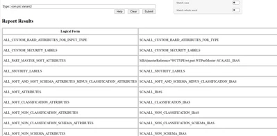

You can use a report like the one attached to get list of all types and then use the logicalAttributeReport  if you info on attribute definition
Buiꓘa

23-Emerald II
Oct 22, 2025 7:06 AM UTC
Buiꓘa
