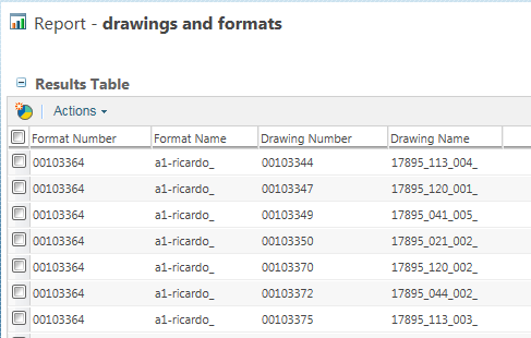

Mike - didn't this do the trick? - qml for Drawing >> related objects, Format

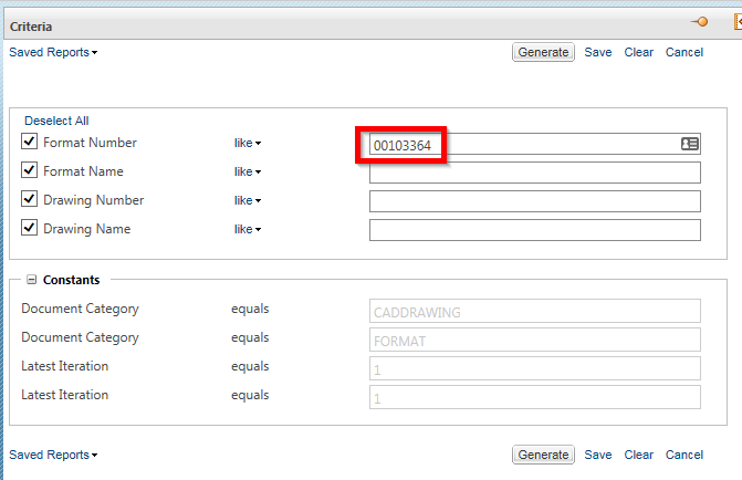

There are quite a few .qml's attached to this thread - and I might have gotten mixed up but so far, not working.  If it seems to work for you (specifically for a given Format, find the Drawings which reference it), would you mind adding in such a way that I get it for sure?  Also would really appreciate a screen shot of it in use as noted - user fills in Format CAD Doc Number, report returns Drawings which reference.

Mar 16, 2017 8:34 AM UTC
Mike
See attached qml...
Tuned a bit for your specific requirements but the report objects and links are the same
