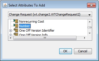

It is because the attributes without a green triangle are derived attributes. This does not correspond to any database columns but are derived through java methods. Derived attributes cannot be used in a criteria for database function like order by, sort and so on.
You can read more about in WHC http://www.ptc.com/cs/help/windchill_hc/wc102_hc/index.jspx?id=QBSelectAttributeWindowAbout&action=show .

Then why are some basic information derived?  Why is "Number" a derived value?
I have a report to show any ECR that does not have an ECN.  I use Change Request (wt.change2.WTChangeRequest2) and Change Notice (wt.change2.WTChangeOrder2) but I can't add the "Number" field for the ECR to the Sort.
