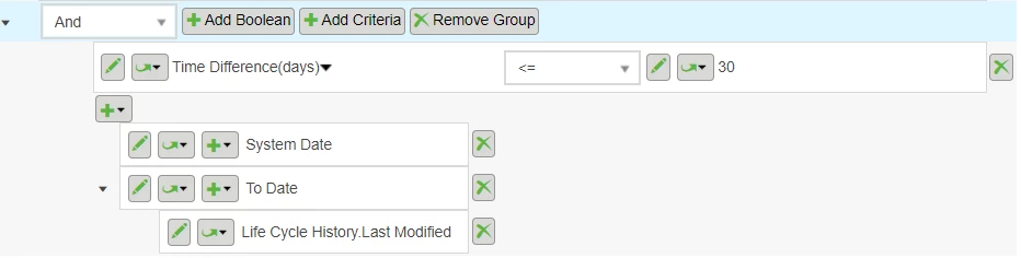

Apr 30, 2021 11:41 AM UTC
In Windchill 11.1 I was able to set a criteria with days while using the Database Function Time difference;
