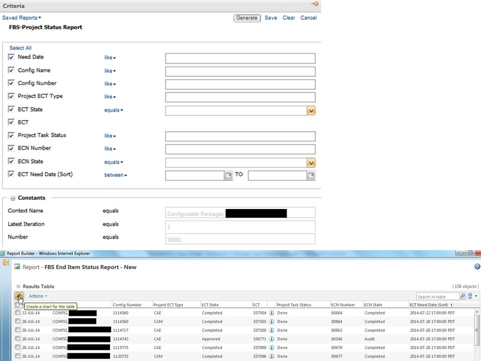

Problem:  How can we use Windchill to present daily project status so we know what is done, what is not done yet, what is done early, and what is late?
Solution:  Query Builder Rocks!  Using Query Builder and some tricks that make it all come together, we have live reports, like the one below, with supporting graphs that we run every day at 5 PM to track status.  Everything in this post is out of the box except for "light types" that we have defined using the Type and Attribute Manager.  None of graphs or reports are customized.  This is possible for any business admin in Windchill 10.1 or later (and maybe earlier) who can set these up without ever requiring a code change or system restart.

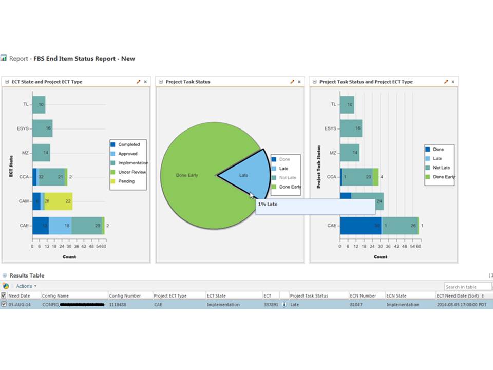

We can export this to excel using the actions drop down, but since this is pre-sorted in Need Date Order, and I can easily manipulate the charts by clicking on the elements that I want to either hide (by clicking on the legend item) or filter the Results Table (by clicking on one of the elements inside of a chart), I don't need excel.  Also, I can use "Find in Table" to additionally filter items to focus on specific items of interest.  I can also click the information icon to look at the details of any task in a new window, as well.  For example, in the report, above, by clicking on the "Done" and "Not Late" items in the legend of the pie chart, the report auto-hides those items focusing on the remaining "Done Early" and "Late" items.  By then clicking directly on the "Late" slide of the pie, the "Results Table" filters to ONLY show the Late Tasks.

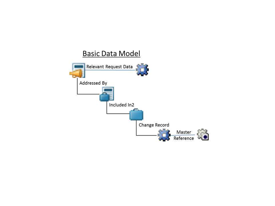

To start, you have to know the basic object model for changes and linked items.  Here is a picture.

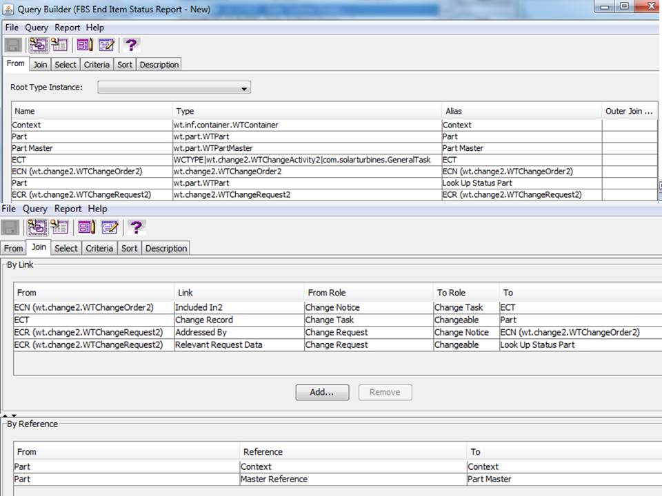

We then set up a master Change Request (ECR) with multiple Change Notices (ECNs) that each have Change Tasks (ECTs).  On each ECT we have Resulting Objects (CAD, Parts, Documents) that need to be approved and released together.  However, not all tasks are equal since some tasks represent major configuration items, while others are supporting tasks.  Our project plan tracks configuration items by part number, and we want to track only those tasks, not all tasks on all of the ECNs.  Therefore, we use query builder to only show ECTs associated with our master ECR that have Part Numbers in our project plan by copying that comma-sparated list of part numbers into an "IN" criteria.
We also have different kinds of configuration items.  We indicated their category with an ECT Name pre-fix.  This is easier than using light types or attributes because the same config item might change its category in our project plan without changing its light type or attributes.  These categories aligns tasks with internal departments, so they are really for status and project management.  For example, an ECT with the prefix "CCA-" is a "Controls Config Assembly", "CAE-" is a Config Assembly (Engineering)", a "CAM" is a "Config Assembly (Manufacturing)", etc.  In query builder we use functions to parse out those prefixes for reporting and graphing.

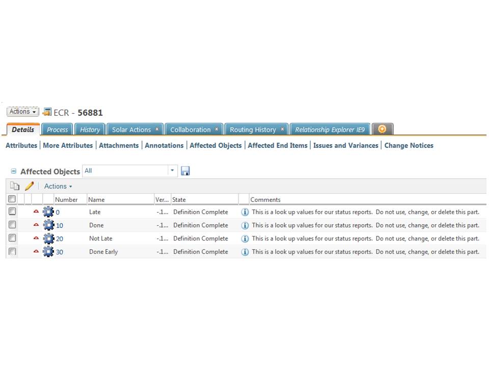

Finally, I wanted to show ECTs as "Late", "Not Late", "Done Early", or "Done".  I did not want to customize.  I did not want to use numbers (i.e. 0 = On Time).  I wanted "done" be be either an ECT in the state of "Completed" or "Approved".  To achieve this, I used a series of functions and some "look up" parts linked to the master ECR to calcuate if an ECT is ahead or behind schedule, and then look up that numeric result from the linked "look up" parts on the ECR to show their part "Name" as "Late", "Not Late", "Done Early", or "Done".  Below is a picture of these look up parts.  They will make more sense later when you see how we use them.

FROM and JOIN

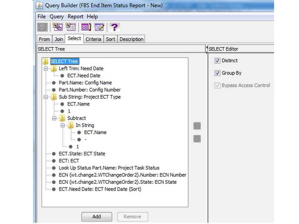

SELECT - Notice the use of "In String" to parse the ECT Name Prefixed into a column called "ECT Type" for reports and graphs.  Also notice the use of "Left Trim" to present the dates in the report without the annoying MM:HH:YYYY TIM suffix that a date columns typically has.  Also notice the "ECT Need Date (Sort)" column, which is needed because you cannot sort accurately on a column that uses LEFT TRIM on a date.
Note the use of "Distinct" and "Group By" for the "SELECT Tree."
Also notice the "Look Up Status Part.Name" that allows me to show "Late" or other text values for the number returned by the subselect, defined, below.

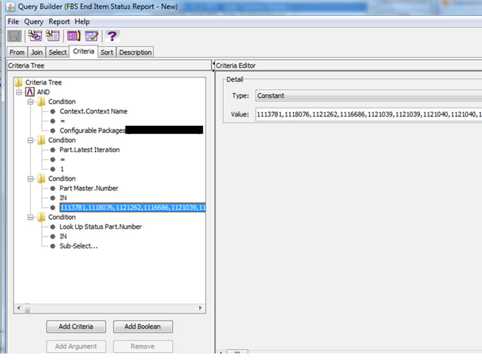

CRITERIA - Notice the Part Master.Number IN clause that lists ONLY the part numbers of our "config items" that we want to report on.  This will only show the ECTs that are linked to the config items in our project plans, not the other supporting ECTs.
Also notice the "Subselect" for the "Look Up Status Part.Number" that allows me to

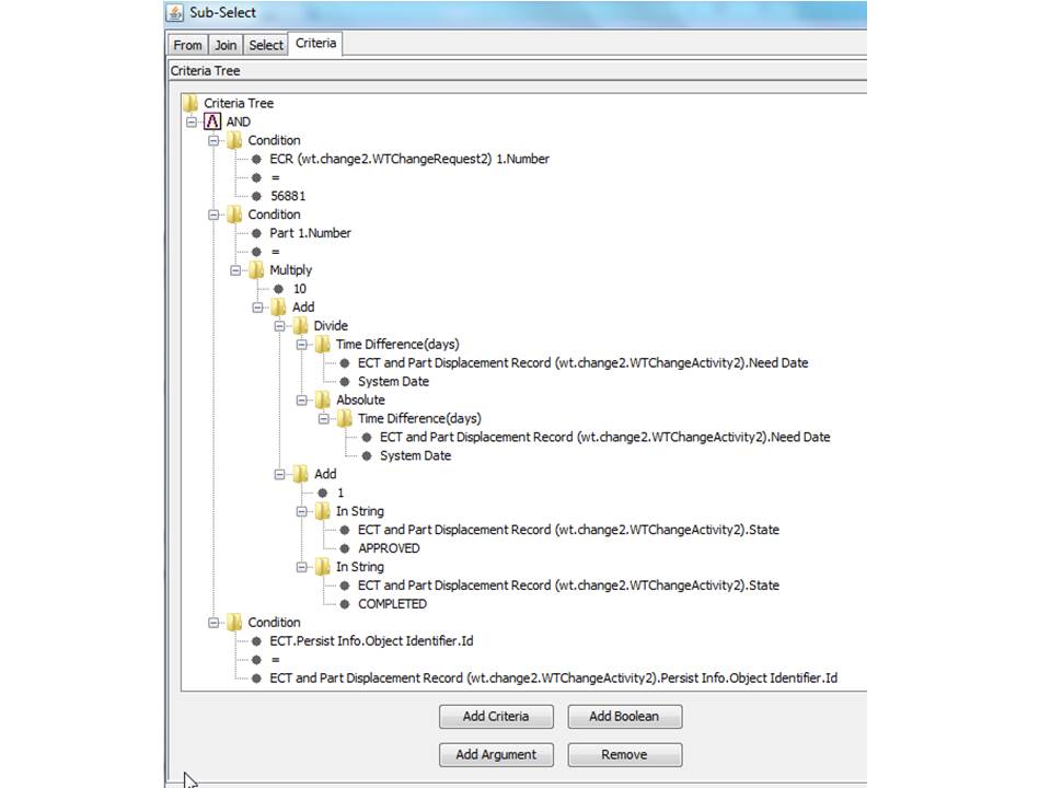

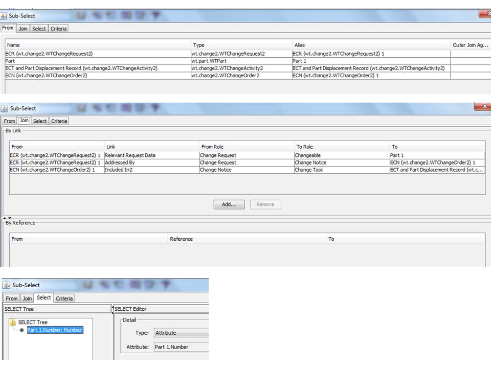

Sub-Select... - This is the really fun part!  This is how we figure out if something is late or not.
This math, below, reduces Need Date relative to System Date (now) to either a 1 or -1 value by the following formula.
(ECT.Need Date minus System.Date) divided by the absolute value of [ (ECT.Need Date minus System.Date) ].
We then have to know if we are "done" yet by state using In String on the states of "APPROVED" and "COMPLETED".  In String returns -1 if the string is not found, and 1 if it is found.  So, this formula, below, results in 1-1-1=-1, or 1+1-1=1.
The on time formula results in 0, 1, 2, or 3.  I wanted to have look up part numbers that match, but in my database, 1 and 2 were used, so I arbitrarily "multiply" the results by 10 to give me Part Numbers I can use: 0, 10, 20, 30.
0 = Late
10 = Done
20 = Not Late
30 = Done Early
And yes, anything "Done Early" will eventually become just "Done" once its need date passes.  This is fine with us!
That is it for the sub-select.  Back to the main report...

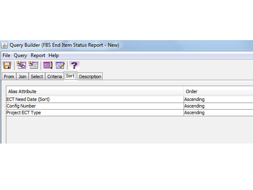

SORT - We finally short by the ECT Need Date (Sort) in Ascending (old to new) then by part number (Config Number) and then by Projectc ECT Type (the ECT Name Prefix prior to the - ).

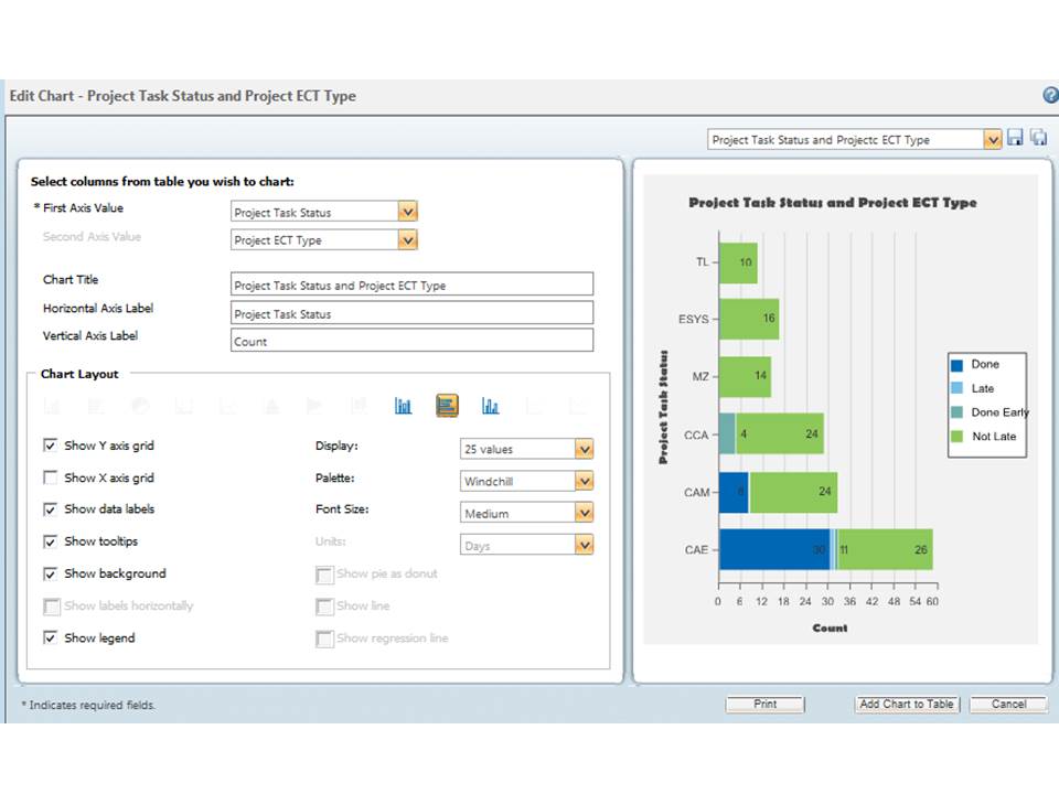

GRAPHS - Run the report, select all the columns, then build your graphs, like this.
In the results, as shown above, click "Create a chart for the table" three times, once for each graph.  The interface for making a graph looks like this.

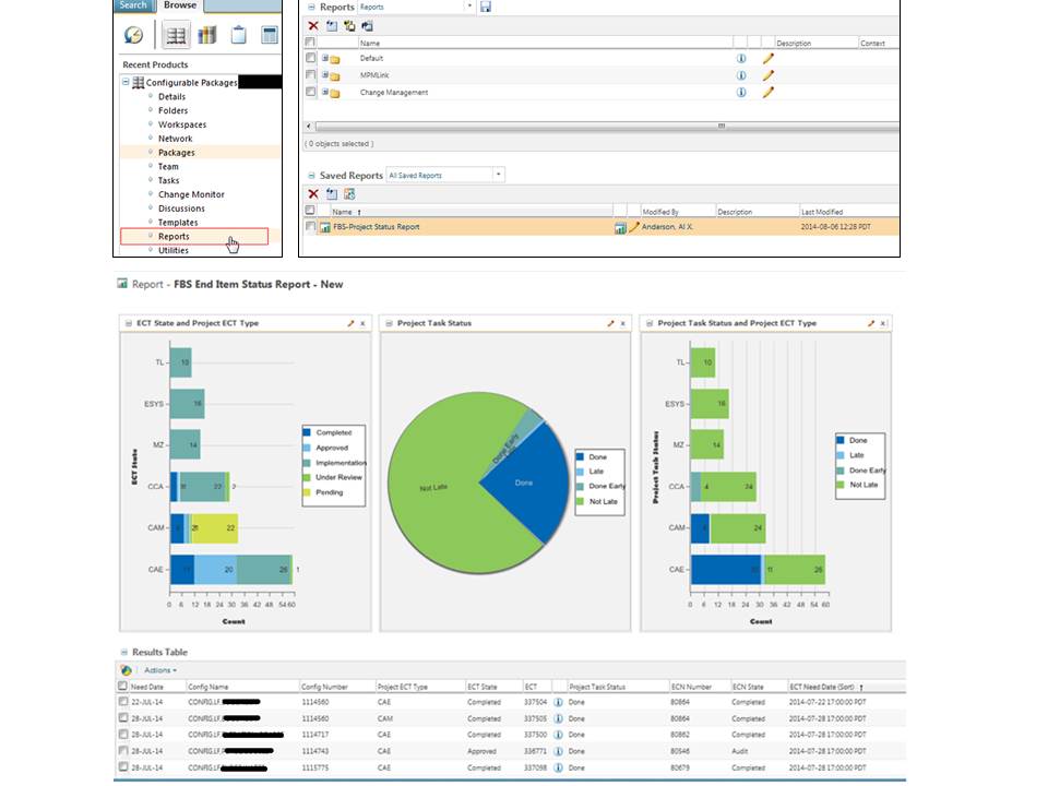

When you like what you see, then Save the Report.  You can then access the report from the context "Reports" link any time you want to run a fresh status report with live graphs!  Here, again, is the first image from above - the fully interactive, sortable, filterable, exportable project status report.
