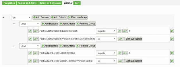

Add the Part object to the report twice, one for each subtype. You can also use a technique to export the QML and make a union. In this case, you would have to different QML reports. export each, edit offline to make a union and reimport back in. But there is no editting online of that merged QML.
https://community.ptc.com/t5/Windchill/TIL-two-things-about-union-queries-in-Query-Builder-I-thought-I/m-p/626642

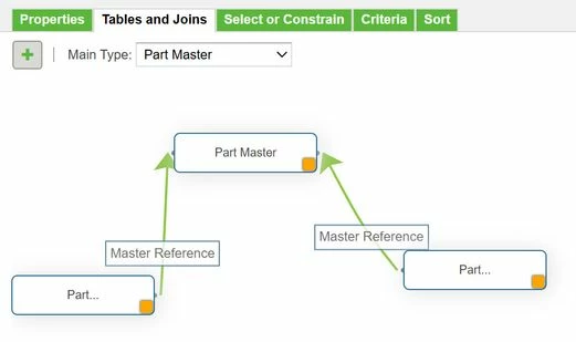

It depends on what the other criteria of the query are, the following has worked for me in some cases.
Make outside joins against the part subtypes to master reference.
Probably best to make a separate report for each type and union them, although I think there's a limit of 2 or 3 unions in a query builder template.
