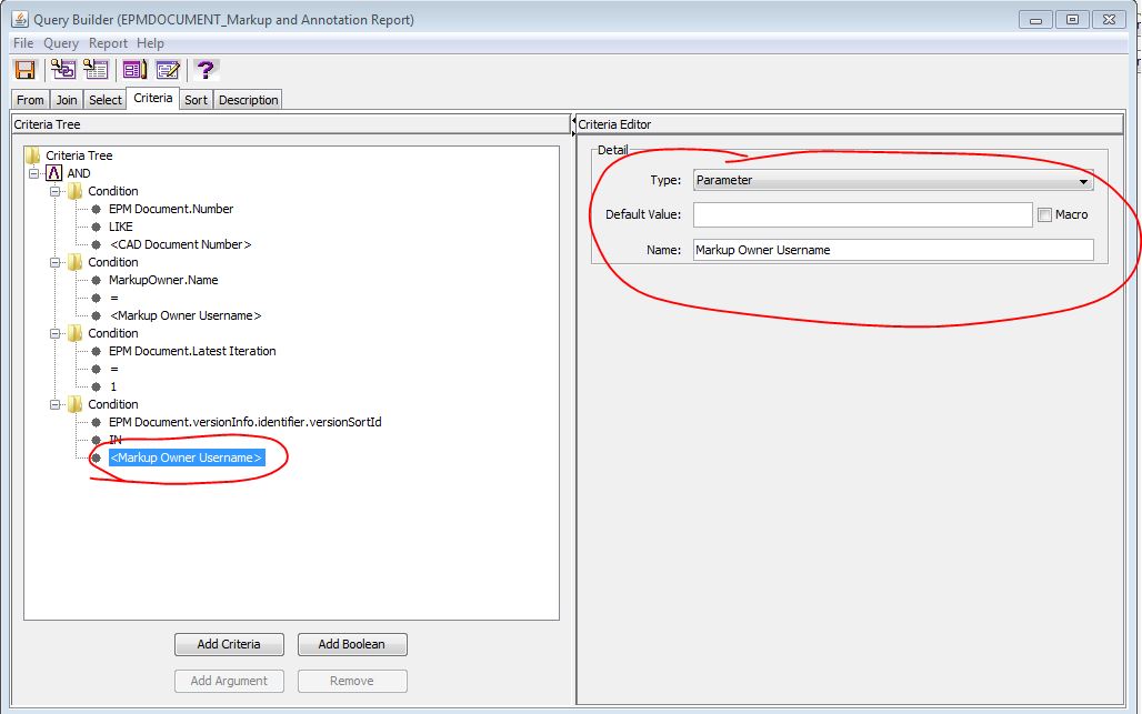

There is no OTB method to directly select Latest Revision in query builder reports.  The technique shown in the following slides needs to be used.

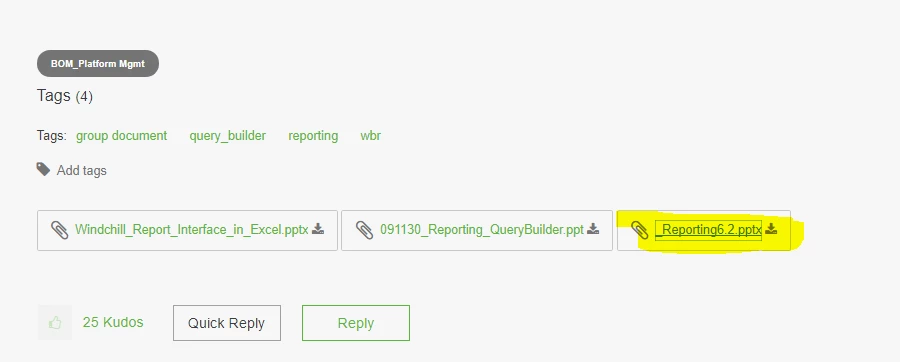

I'm not seeing the sub-select menus as shown in presentation.  What am I missing?  Picture is from WC10.1.
MarcoTosin
Sep 4, 2015 6:17 AM UTC
Bill,
take a look at this presentation https://www.ptcusercommunity.com/servlet/JiveServlet/download/6348-62-73173/_Reporting6.2.pptx (see pages from 53 to 62).
Marco

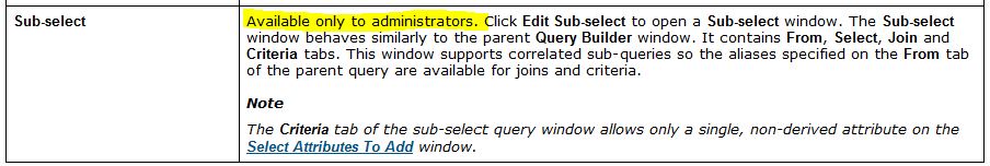

Sep 4, 2015 1:06 PM UTC
Thanks very much Marco.  I had seen the comment in the resource for reporting thread about this powerpoint...but dismissed it because it was related to WC6.2.  Would never have thought this functionality was still basically the same!
This is my issue.  The option is not exposed with my current credentials.
MarcoTosin
Sep 4, 2015 1:23 PM UTC
Bill,
at the moment, even if it's for 6.2 version, this is the best document PTC shared to customer about reporting.
I hope this is changing and, if you read this discussion, you will see why.
