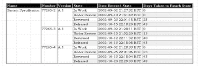

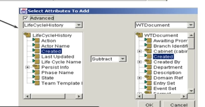

Example of a report showing how to calculate Days in a Lifecycle state.  This uses older UIs, but the methodology is the same in newer Query Builder

Thank you for this powerpoint presentation showing how to calculate Days in a Lifecycle state.
You wouldnt perhaps have this in a QML format.?
I am using Windchill Release: 12.1.2.9 and I am not having success creating a report on how to calculate Days in a Lifecycle state.
What you show on your last slide is exactly what I need.

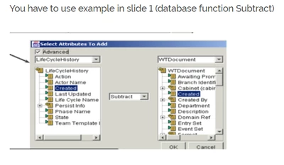

MarcoTosin
July 24, 2024
You have to use example in slide 1 (database function Subtract)
Marco
11-Garnet
July 24, 2024
Hi there
I do not have this interface. What version of Windchill is this.?
