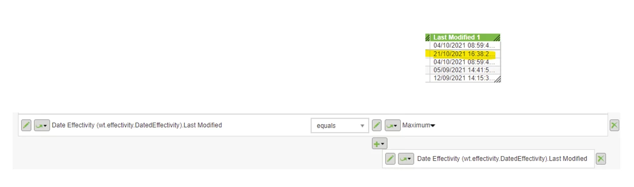

Hi
What is the right way to retrieve the Maximum (Last modified) date in Query builder?
I have tried this option (see picture) but didn't succeed

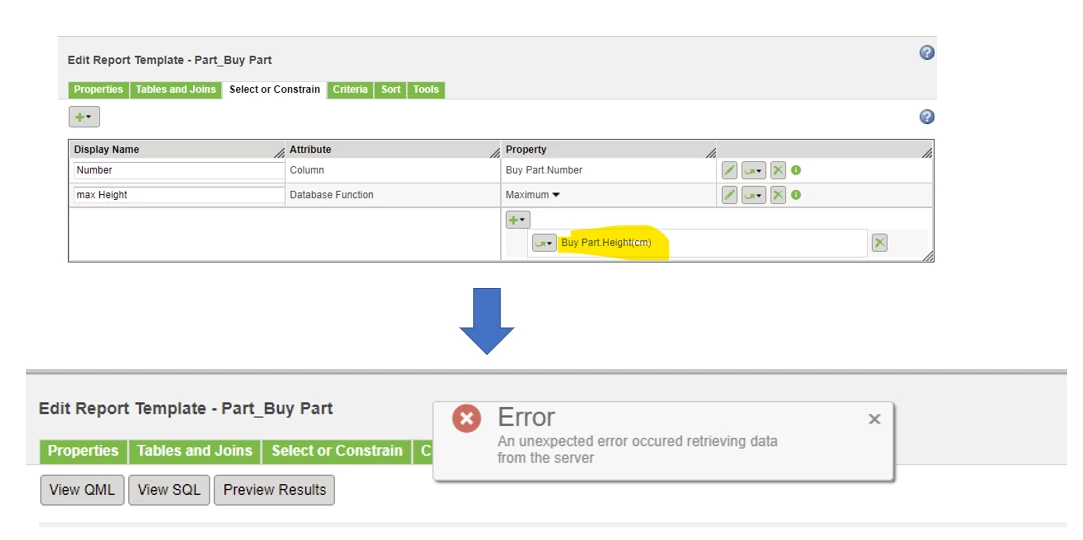

Nov 24, 2021 2:32 PM UTC
Here's an example of using the Max function. I believe you can only use it in a Subselect.
This query will return info on the Part  with the highest value for "Persist.Info.Object.Identifier.Id"

Nov 22, 2021 6:19 PM UTC
Maximum doesn't really work that way. You can return the maximum value for a number value, but not for a date.
If you just want to get the last modified version of a document, you can use a subselect to get the latest revision, and add the criteria to get the latest iteration. Since you have the latest version that typically should be the last modified of the document.
If you wanted to be more sure to get the latest modified (again, I'll use a document as an example), you could do a subselect and return the maximum object persist ID. I believe Windchill assigns these numbers sequentially, so the maximum you get will be the most recent created.
Hope that helps!

Hi Joe
I'm trying to understand how to use the Database function, so I tried to display maximum of 'Height' (defined as Real Number) ,but I got an error message (see attached picture).
What am I doing wrong?
thank you
