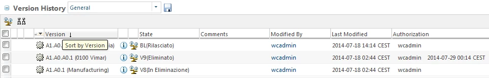

What I would like from your suggestions point is:
1 - OK
2 - OK but not iterated, because we align state from SAP with a set state without iteration
3 - It could be useful but not mandatory
4 - It could be useful but not mandatory
5 - This information comes from the comments (iteration note) field, where we write "Updated from SAP Importer" when we iterate part to update attribute, so I know where to find it.
6 - It's not necessary
As you can see in attached image (second row), we set V9 state on a WTPart last night (Authorization column) by using wcadmin.

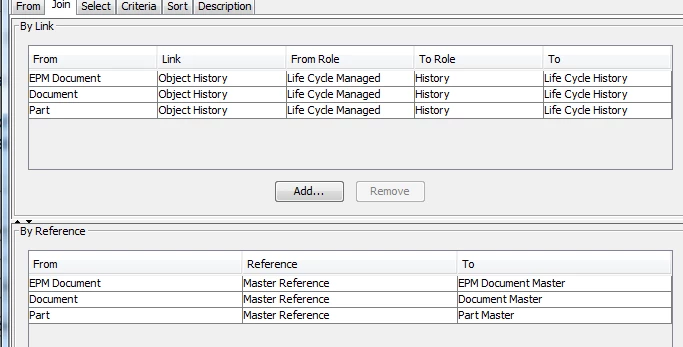

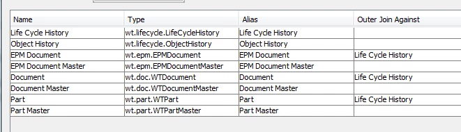

Ok so your original description using "modified" meant "state changed."
Then it's a matter of joining WTParts with object and lifecycle history.
Here's a similar report that we have that finds the Set State action for WTParts, WTDocs and EPMDocs (which can be done by some leads). It excludes those done by robot (Administrator actor). You may want to reverse this - include robots and exclude people. Note - The outer joins are only needed if you're reporting on multiple types - don't need for just WTParts.
[cid:image001.png@01CFAB04.7814C640]
[cid:image002.png@01CFAB04.7814C640]
[cid:image003.png@01CFAB04.DE4CFCC0]
