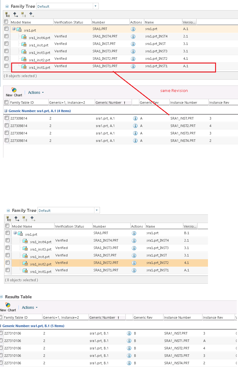

query builder report - family tables with instances not at same revision as generic
  • June 10, 2016
  • 7 replies
  • 4769 views
Recently I had to find all family tables in our system in which any instance did not match the generic.  This .qml does not have a criteria to find this, but finds all needed info and I was able to filter in Excel using text functions.  Provided just in case anyone else can make use of it.
The attached file is named for a tech support case.
I'd still be interested if anyone can come up with a way to filter for revision of instance not equal to revision of generic.  Didn't work very hard on this - I'm a wizard for these things in Excel.

I don't see any difference.  note: Improved a bit since posting, but still getting results that are not latest Rev for some instances.  Latest that I have attached.
June 13, 2016
Report works for me as expected see below screenshot.
22-Sapphire I
June 13, 2016
Got it working - see attached
