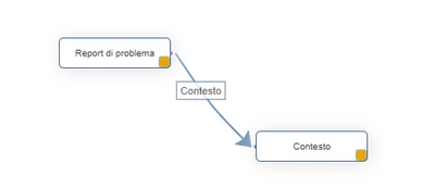

Use Case: I have created a custom Report template at ORG level, this query builder report will generate results for all Problem Reports which were "COMPLETED" in past 7 days,
Description:
I have also exposed this template as Reports in Library context, but when I run the report in any Library context, it gives me results from every context and not specific to the Library context where I am running this from.
Is there any way I can specify context specific search based on where I execute this report from?
MarcoTosin
November 20, 2025
What you did was make a report, created at the organization level, visible in every single library.
This way, there is no context filter that needs to be created by adding the context table and linking it to the Problem Reports table and MANUALLY selecting the context you want the search to be performed on.
Something like what you see in the image below.
