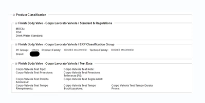

May 16, 2024 2:44 PM UTC
Herein the list of attributes

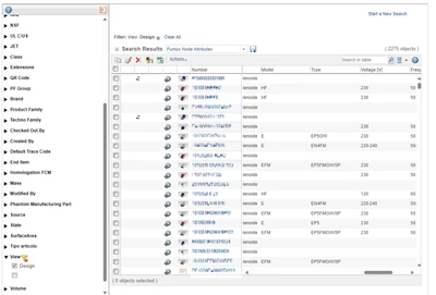

Jun 21, 2024 6:48 AM UTC
it's a pitty.
What I'm looking for is to create and send a report exactly as the attached search results.
BR
Gianpaolo
