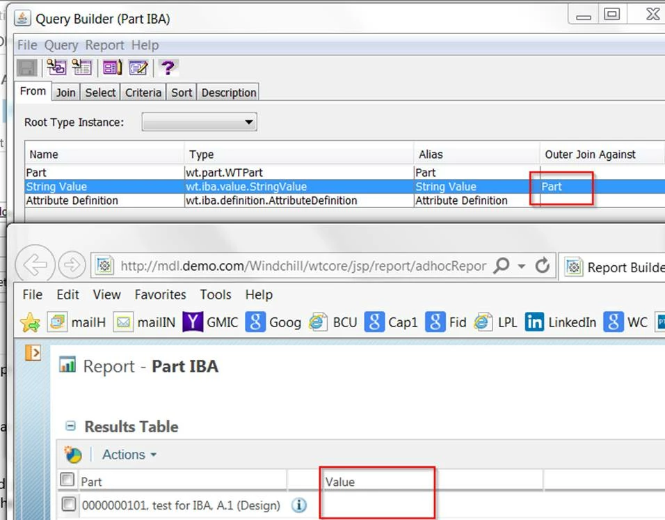

Greetings Gurus,
I am trying to query the part name, number, and a string value of IBA from WTPart. When the IBA has an empty value, the report returns no results at all. I would like to at least have it return the other attributes and show the IBA is empty.
Here is what I have:

22-Sapphire I
Feb 11, 2015 7:35 AM UTC
May need to use Outer Join on the From tab for String Value relative to
Part.
Returns Parts which do not yet have a value for String Value.
cswaner10-MarbleAuthor
Feb 11, 2015 4:47 PM UTC
Greetings Mike,
Thank you for the feedback. As you can see from my previous post, I did try the outer join precisely as you suggested. From some reason it does not work on my system. Can you tell me which version of Windchill you used for the images you posted?
I am using Windchill 10.1 m010 on MS SQL (not sure of the version).
I suspect this is either a bug with WC 10.1 m010 or the SQL does not work properly with MS SQL.
I have an open case with PTC to determine.
Cam

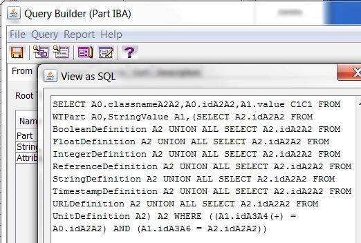

22-Sapphire I
Feb 11, 2015 11:24 PM UTC
Using 10.2 M020 - with Oracle 11g R2.
SQL - may be helpful to examine but probably not
SELECT
A0.classnameA2A2,A0.idA2A2,A1.value C1C1
FROM
WTPart A0,
StringValue A1,
(SELECT A2.idA2A2
FROM BooleanDefinition A2
UNION ALL
SELECT A2.idA2A2
FROM FloatDefinition A2
UNION ALL
SELECT A2.idA2A2
FROM IntegerDefinition A2
UNION ALL
SELECT A2.idA2A2
FROM ReferenceDefinition A2
UNION ALL
SELECT A2.idA2A2
FROM StringDefinition A2
UNION ALL
SELECT A2.idA2A2
FROM TimestampDefinition A2
UNION ALL
SELECT A2.idA2A2
FROM URLDefinition A2
UNION ALL
SELECT A2.idA2A2
FROM UnitDefinition A2) A2
WHERE
((A1.idA3A4(+) = A0.idA2A2) AND
(A1.idA3A6 = A2.idA2A2))
