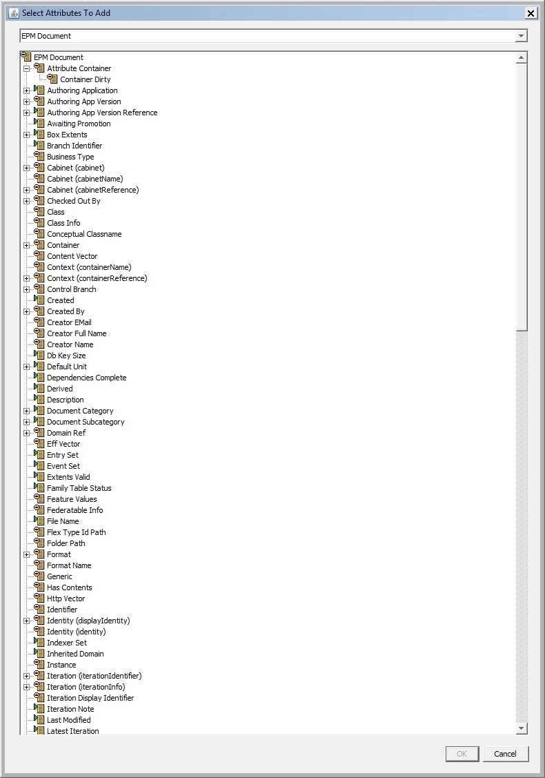

Hello everyone.
I found this query builder on PTC Help website (see attached file AllLatestEPMD.qml). It has helped me to get started but this is not sufficient.
The report, as you see in the qml file, will list all EPMDocuments in winchill (regardless of the contexts). The original output only shows Name, Number and Version. This is for me not enough. I manage to add Life Cycle State, Context Name but I also want to list some of our soft attributes. I struggle to find which option to select from that menu (I hope this is the correct menu as it is where I manage to add Life Cycle State and Context.
I have attached the original report, the modified one and a screenshot of the menu I am trying to find where I can see my list of soft attributes for EPMDoc.
Any help welcome.
Thank you
January 17, 2013
You should see all of your custom attributes at the bottom of that list in the screenshot you sent. That is where I see mine. They are a different color (greyish).
[cid:image001.gif@01CDF48F.557712A0]

January 17, 2013
Hello Steve
thanks for the tips. We found them but in a different object type. Workgroup CAD Manager !!!!
