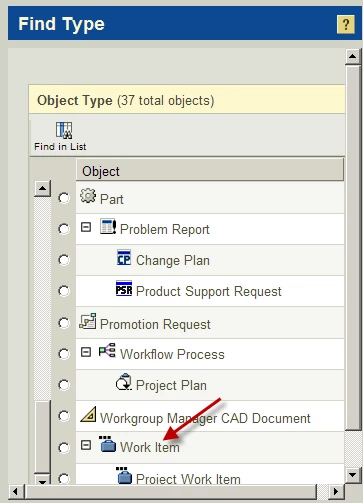

I couldn't pick the workitem from object type in advanced search even though i set the workitem class in "All Applicable Object Types Search" under "Search" in preference manager.
Is there any recommendations for resolving this issue?

22-Sapphire I
November 16, 2011
9.1 M040
Preference
[cid:image001.png@01CCA432.6E776420]
Needs to include: WCTYPE|wt.workflow.work.WorkItem
[cid:image002.png@01CCA432.6E776420] [cid:image003.png@01CCA432.6E776420]
[cid:image004.png@01CCA432.6E776420]
November 16, 2011
Saravan,
Mike's instructuion is accurate and should resolve the issue if you follow it.

Saravanan10-MarbleAuthor
November 17, 2011
Resolved the issue. Thanks for the pointers.
