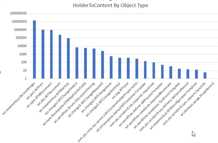

This is a share not a question. As you can tell, I am revaulting my system to enable automatic folder creation and move data to a new volume. I've opted to feed the beast on off hours by altering vaulting rules and then revaulting so as not to impact users during the day. I needed a query to estimate the size of the job I was kicking off by context so I can control it. I started with this query from knowledge base:
How to find vault file name and location of all objects in vault for specific context in Windchill PDMLink
I generalized to just give me a count but this only handles 3 object types, something was missing. Looking at HolderToContent table, I can see it was DerivedImage where most of my files are from which makes sense.
Note this chart is in log scale so published content is about 10x everything else. Makes me want to consider flipping on publish as .pvz. Everything else is small potatoes so I did not include in my query so this gets the top 4 content items. I ran this on my test server and it executed in 100 seconds.

This was very useful in breaking up my move to nightly runs by groups of products. So far things are going well.
