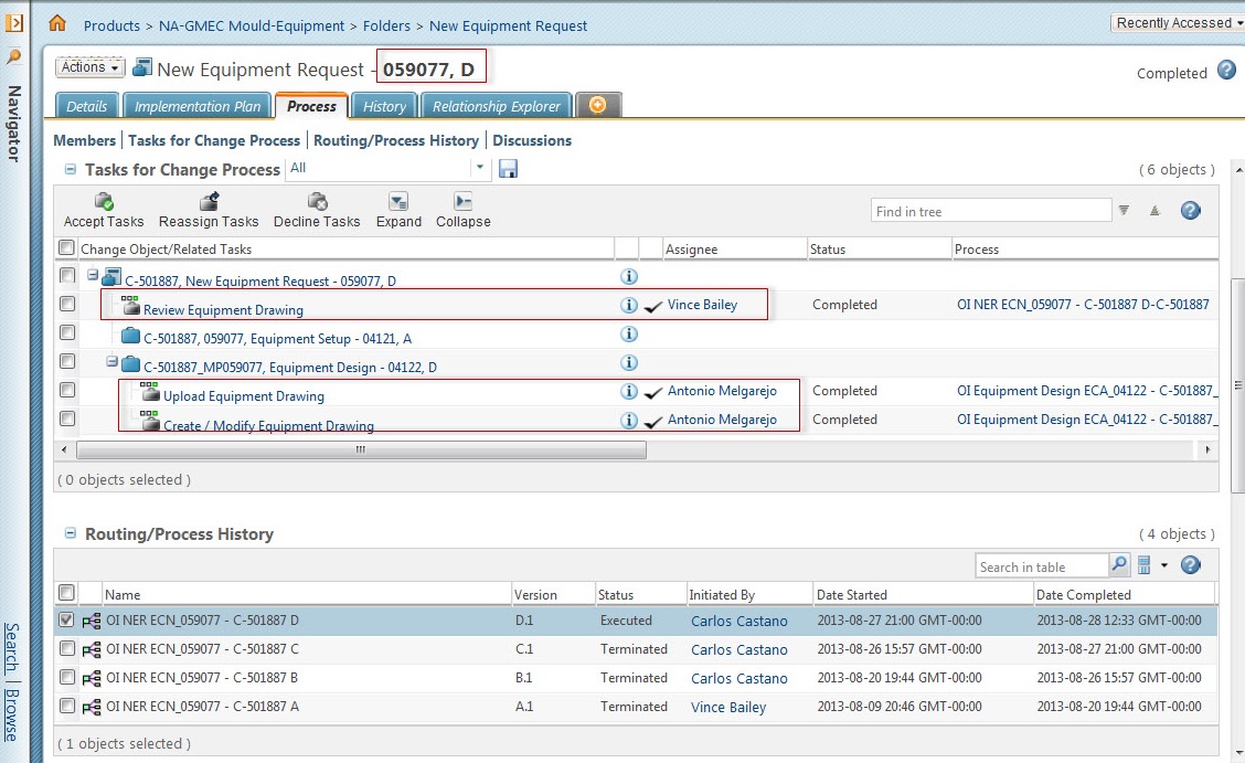

My Change Notice Page,

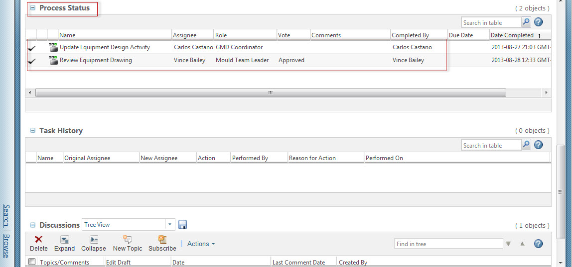

I want to fetch data from Task for change process table and process Status table as shown on page.
I am able to fetch the data from "tasks for change process", but not able to find data from "Process Status " table.

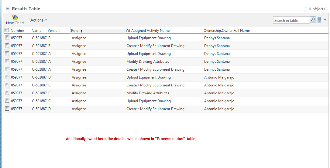

Here is report output for above change notice, we will notice that fields from "Process Status " tables are missing in reports.
Please let us know, how i can include this additional data to report.
