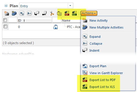

Regarding the question, there is a way to add standard export actions to tables in Windchill. When I was the ProjectLink guy, we implemented it for the Plan table and documented it in the Windchill Customizer's Guide under the topic named "Adding Export Functionality in the Project Plan Table". Those pages are attached for quick reference.
My assumption is the same capability should be available in the core ui, but I am not sure which XML file controls the various folder browser tables.

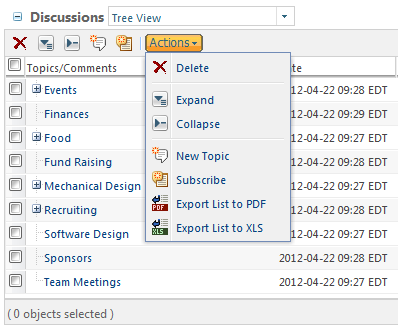

PTC implemented some of these actions on the Academic Windchill server used by students in the FIRST, RWDC and Formula SAE programs as shown below.
They are also available in the Discussions table of a Project container.
