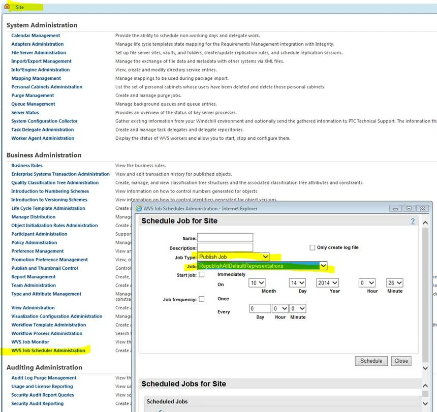

Due to changes in our publish rules (additional files) and the creation of a publish filter (for extended positioning assemblies), I need to republish everything.
Unfortunately, manually republishing ignores the new publish filter. To make it work, all existing representations have to first be deleted, then the objects submitted again for publishing.
Does anyone have an easy way to delete and re-publish the latest iteration of each revision of all cad documents?
If not, what about deleting and re-publishing the latest version only?
Last resort, does anyone have an easy way to simply delete ALL representations system wide?
Thanks!

October 14, 2014
Would this work?
[cid:image001.jpg@01CFE70A.EB8365E0]
[cid:image001.gif@01CFCB30.A000F600]

October 14, 2014
Nope. A republish ignores the publish filter. According to PTC, the publish filter is only processed on a "publish.publish" event. When republishing the "publish.republish" event is used instead. So far they haven't been able to figure out how to connect another filter to that event.
